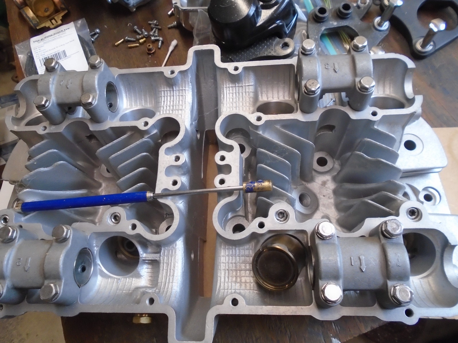

Cartal the blasting process normally doesn't "erode" that pot aluminum, does the opposite, lifts the grain. This will cause the bucket to catch in the bore. PLEASE don't use that flapper wheel, you Will distort the bore and not even that brake hone, not necessary. Rolf, you are braver than i using that much grease in the bucket bore!! The thick viscosity of that stuff "can" slow down reaction time and You could end-up hanging open a valve as the piston approaches TDC and bend a/multiple valves!!

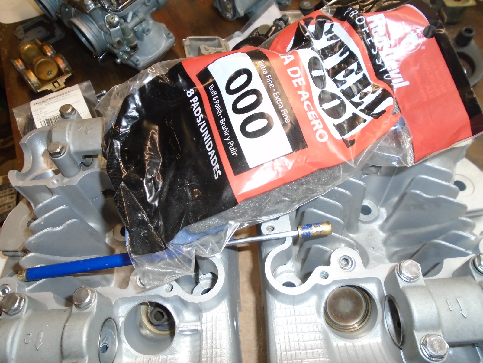

Just a big wad of steel wool with a bit of light viscosity oil to polish it up, power-wash after using some store "engine cleaner" to remove the debris. That bucket "might be ovaled like Wookie mentioned, overheated. This happens a lot of times because of running too tight clearances so the heel of cam remains in contact with shim, friction heat transfer.

Thank you for your comments. The steel wool approach sounds like a good plan.
regarding buckets being oval, i ran them over a flat surface, and they seem to be ok. I will do the same steel wool treatment to them, and post back results

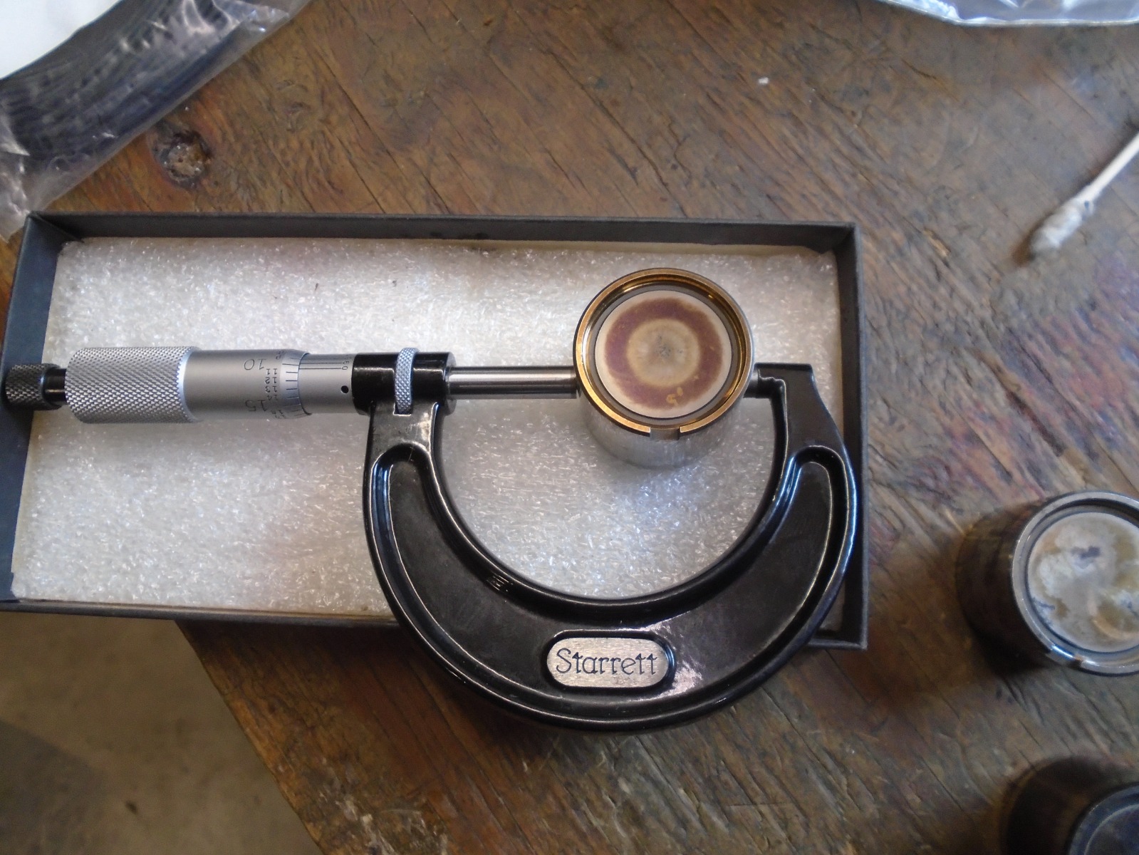

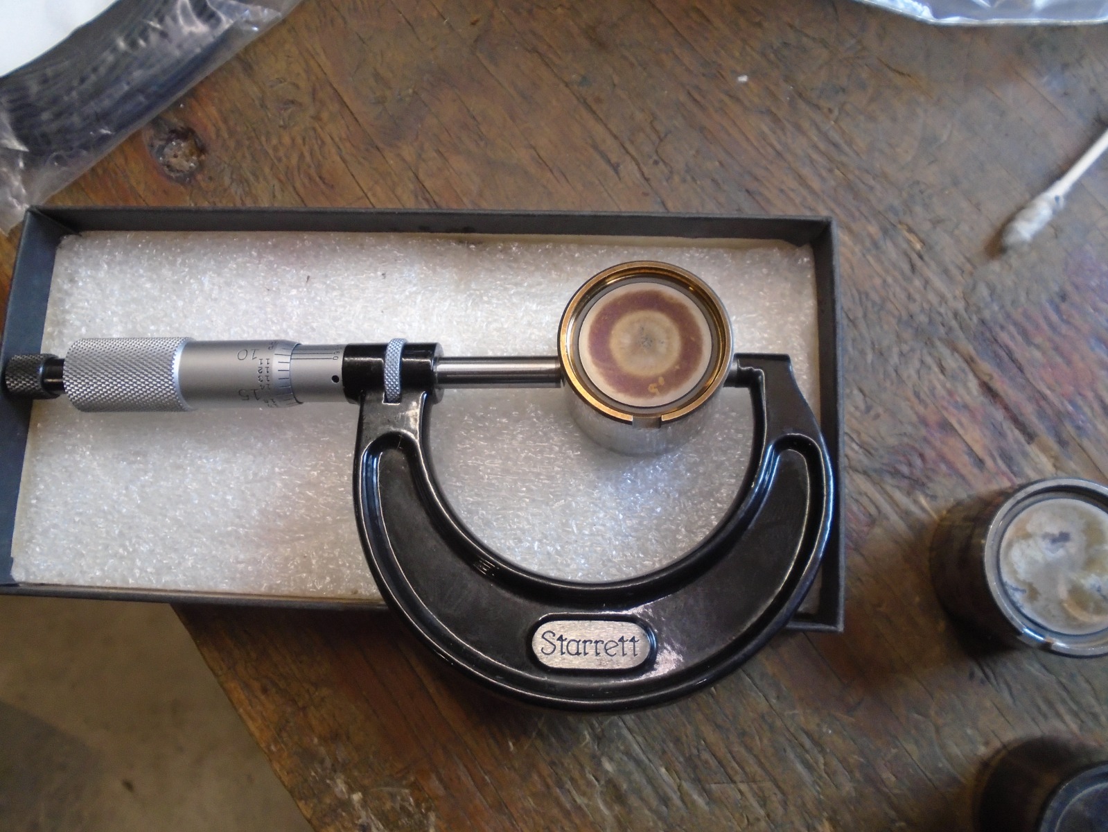

Here to help. As far as being oval, running them over a flat surface, if i understand what you're say, isn't what you need to check. They normally don't "flare" they warp like an egg. Need to check inconsistencies in diameter, pic shown.

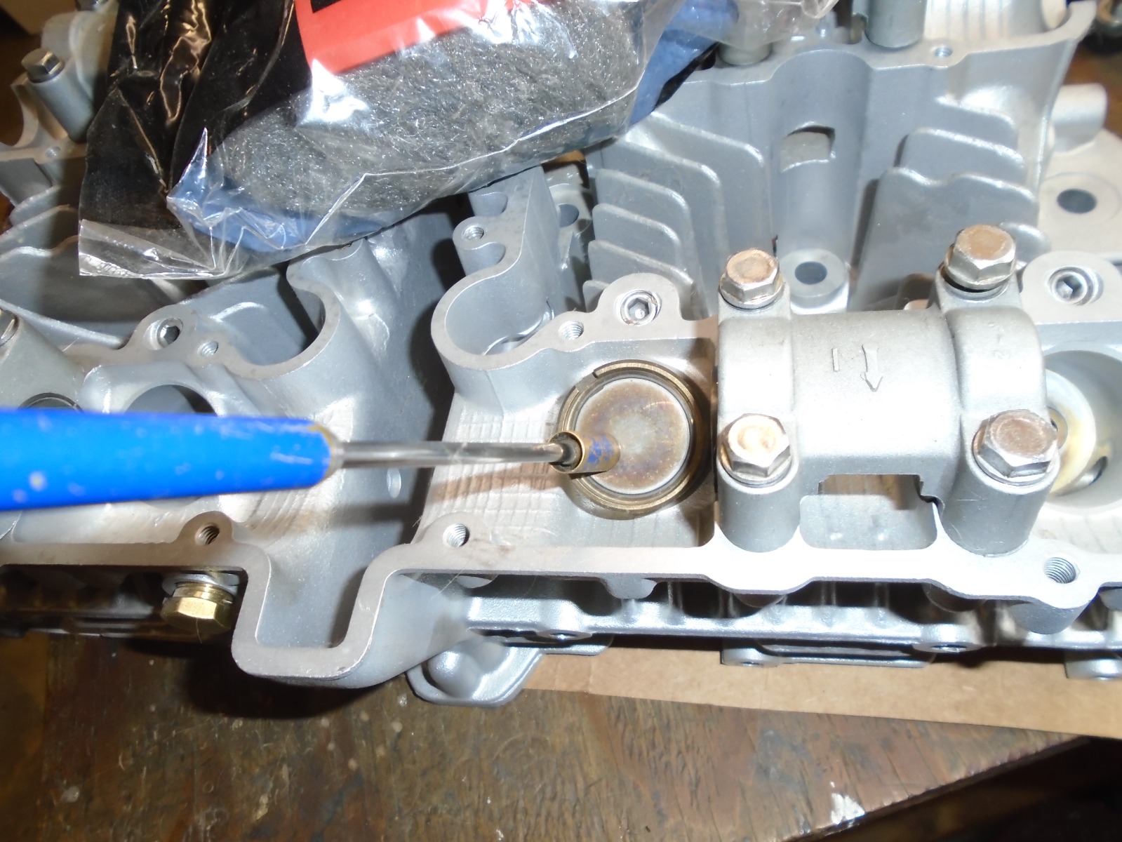

Stuff if it helps. Knocked the cobwebs of this thing sitting. Same premise, maybe different style of head but he same concept. A nice complimentary bucket to bore, when dropping the bucket in should seat with a "ting" when it goes to the bottom. Yes that's an "industry term", ha. Regardless, should be easy to pick-out with a pocket magnet. When first aligning the bucket it may prove fractious but don't just smack it, it'll find it's Happy spot and push right thru. If You force it you'll just be whacking off shards of aluminum and forcing it in the clearance area.
