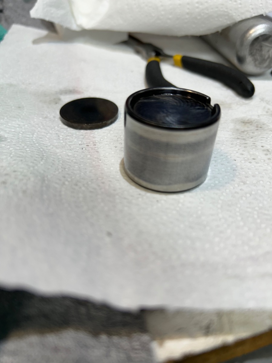

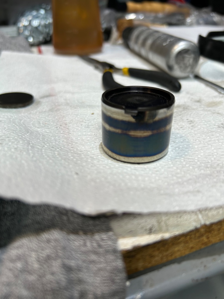

That shimbucket may need to be replaced because of overheat .If the bores are not smooth you may use a mini honingtool like for brake pistons to just get them smooth.

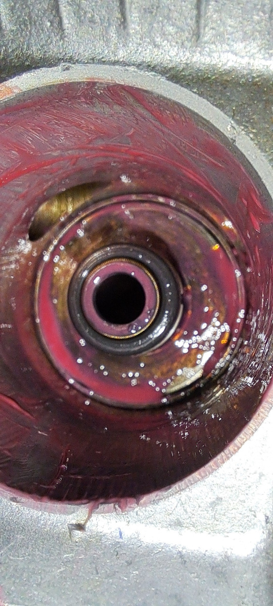

I think you only need to change out the one that is bad or worn. You can find used buckets on e-bay i think or maybe someone on the forum has some for sale. Do you have a pick how the bore look inside ?

So, finally, the bucket came out. Some heat from a propane torch, penetrating fluid and a soft approach with a vise grip made it happen. No brute force was used, no damage done.
Once all valves are out again (I’m getting really good at it!), I’ve measured both the buckets and the “pits”, for lack of a better name.
my surprise is that the pit’s width is roughly 32,70mm, but there is no bucket that will measure less than 32,80. No wonder they don’t fit well.
my question is: Could have buckets been damaged because of heat (or whatever cause) making them to “expand”? Don’t forget this was a severely mistreated bike in the past.

Wow, what you have here is "one of life's little mysteries" the head can't shrink and the buckets can't "expand" any stay there when they have cooled. Have you measured in several places to ensure the buckets haven't become oval. If the buckets have distorted then the solid part at the top should have remained round - have you tried slipping the buckets in "upside down" to see har far in they will go before you feel resistance ?
With regards keeping parts in their original location - ideally yes as the parts wear to each other like your feet and your favourite shoes, however it's common practice to swop shims to run on different cam lobes when adjusting clearances. The head is softer than the bucket so there shouldn't be significant wear on the buckets. Given that new buckets would come in at €480 for a full set, personally if I found the buckets were distorted I would consider "used" parts if the condition was good and they measured up in spec.

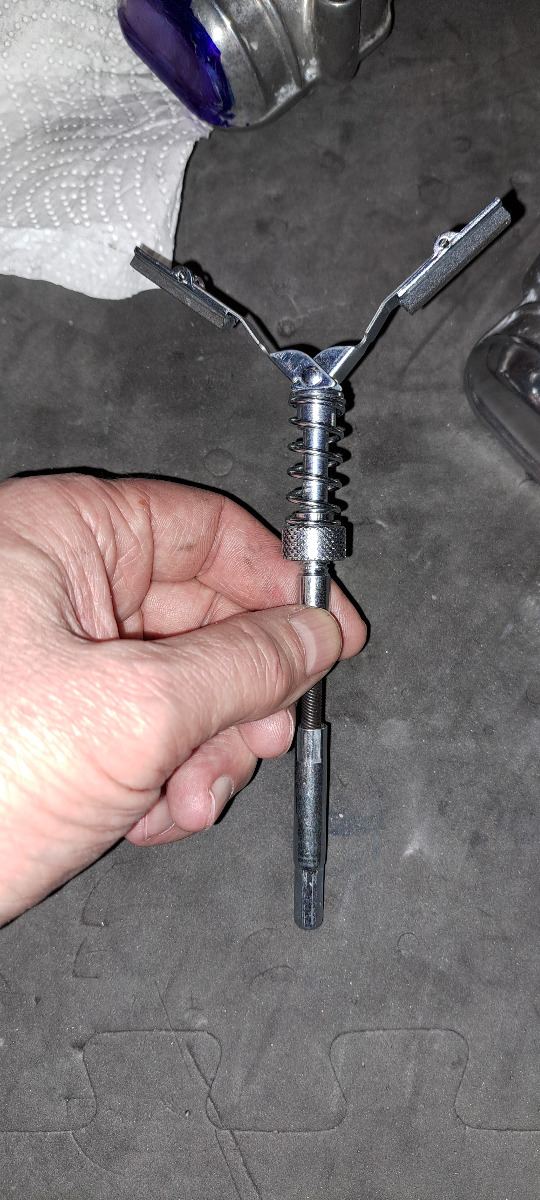

Was the bores for the buckets blasted? the surface should be smooth .If i was you i would try to hone the bores super light with a hone like in the picture.I have never done that before and cant guarantie that is safe,but the bores will be smooth at least. I leave this for the experts

In any case, I will clean bores tonight well with a good solvent, and then give them a go with emery paper. Planning to use one of these:
