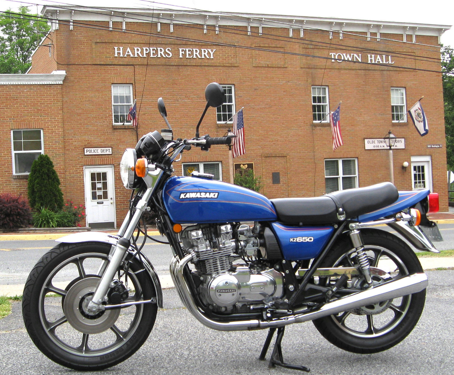

From the pic posted it appears to be a C3. A couple of things to keep in mind. When the bike (1979) was new the fuel was different than it is now. Info I have shows fuel capacity at 16.8 liters which equals 4.4645076849 US GAL
