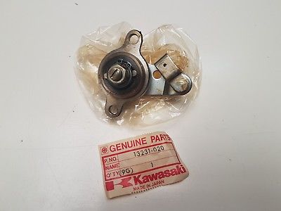

The later model clutch release (1979~1981) is a far better quality clutch release than that white plastic thing. It is very common to upgrade to that later model clutch release.
Here is a picture of the late model Kz1000 clutch release. Best release Kawasaki ever put in their 4 cylinder bikes!!!! Drops right into your cover too!!!

Both good ideas from Wookie and Dr Gamma. Even if your clutch release is OK it's worth taking it off for a clean, greasing, and reassembly.
The next thing I'd recommend checking is your clutch actuator rod (the rod pressed by the clutch release under the sprocket cover). These can wear where they rub the housing, and can develop grooves which can catch on the housing and can suddenly release as you let out the lever, and it will feel like you've dropped the clutch. Pull the rod out and inspect it - if it's bent replace it, if it's got grooves you can just turn it around and put it back in the other way, that way the housing will be rubbing where the rod isn't worn.

Ditch the cable and purchase a new one. Then lube before install. A new cable is a thing of beauty, far better than an old one that's lubed. Oh, and get a OEM cable. Not a motion pro or some other aftermarket cable.
Also, as mentioned, get a new style three ball ramp mechanism. They are way better than the older release mechanism. My 1981 750 had the better ramp mechanism, but a 1980 parts engine I bought didn't. I'd look for cheap later year sprocket cover and take the mechanism from it.
