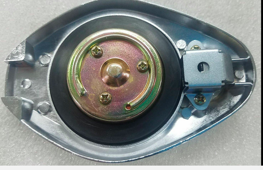

RIght but this is what im getting at.
Is there a away to VISUALLY inspect the vent to see if its blocked? Lets say I do what gd4now tells me and leaving the lid open solves the problem. THEN what to I do to SOLVE the problem?! No one has mentioned HOW to clear a blocked tank vent.
Re: My KZ750 nearly got me killed today. Need Older Guru Help
30 Jul 2022 08:50 - 30 Jul 2022 08:50
You’d have to post a picture of the inside of your cap. On my big4’s there are 3screws to remove a yellow chromate cap, under that is a paper gasket and it covers a winding grove in the upper half. At the end of the groove is a hole. If it’s plugged or an insect has built a nest in the groove you’ll see it.
30 Jul 2022 09:00 - 30 Jul 2022 09:01
OK so the fix or way to inspect other than riding with the cap open (which I will do anyway) is to remove the three screws and inspect it. Got it.
My cap looks like this:
30 Jul 2022 09:31
Looks just like mine. You can take it apart. Take photos of each step so you get it together correctly
30 Jul 2022 09:34
Yes you can look at cap and clean if required without driving with the cap open. Is the pic you posted your actual cap as it certainly looks brand new to me and if it is yours then the vent may not be the cause of the issue. IMO it is still worth a test.
I did not word my response well, I just felt like it was an easy way to test if the vent was the issue, without pulling carbs or petcock to look for the problem. Which you will most likely have to if the vent is not the issue.
When I am attempting to find the cause of an issue I first try to see what could be the cause and then try testing the easy things to test with out pulling parts till I prove to myself that they are not the cause of the issue.
