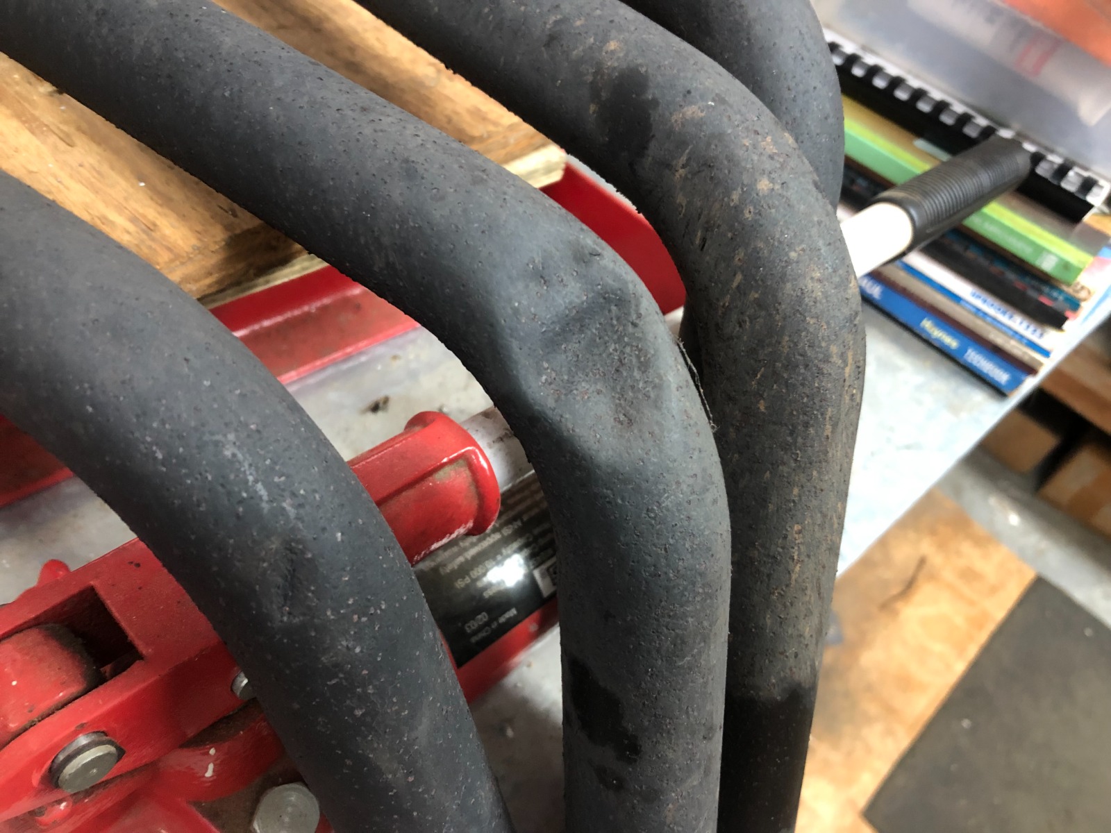

Hey All, the exhaust is off the GPz for a bit while I do some engine work. I really hate the finish on my pipes and was thinking of having them ceramic coated. i would like to have this dent repaired beforehand. Ideas? I'm thinking it would need to be cut out and replaced.

This is an older Kerker so the metal is plenty thick. And, where the dent is is right at the bend. I'll probably take it to welder and get an opinion. I know a guy who teaches welding and is sort of the local guru for motorcycle frame welding. hopefully he's still around.

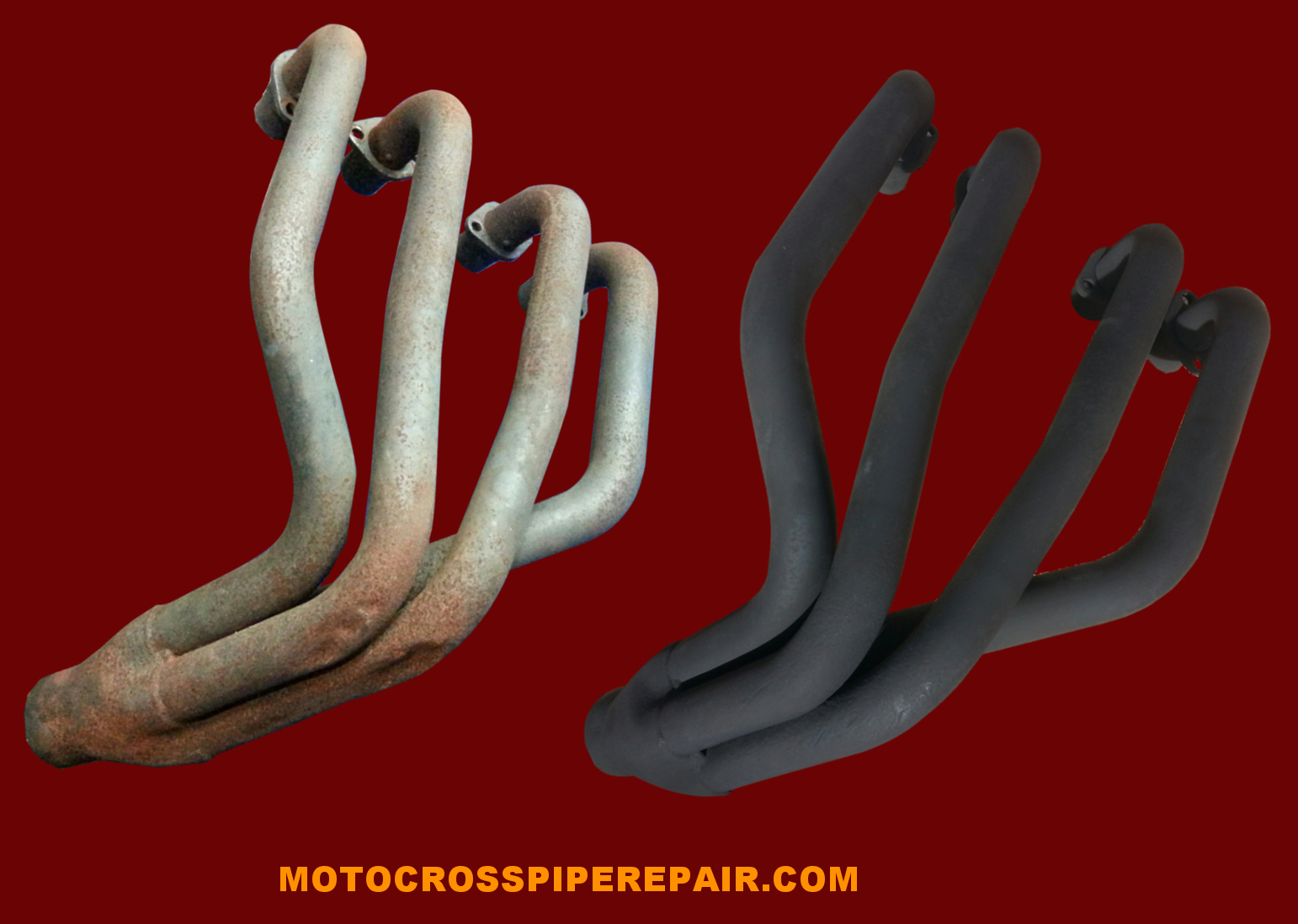

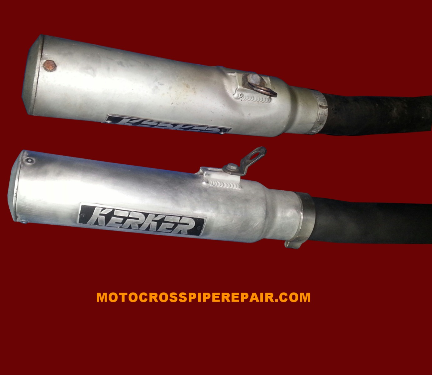

I had this guy remove dents from a kerker header a few years ago. The exhaust looked great and the price was reasonable.
motocrosspiperepair.com/
Edit: Here are pictures he sent of my own pipe when he finished it.
