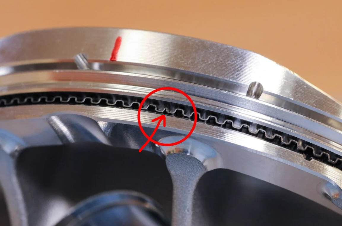

Did you make sure the oil ring expander spring isn't overlapping?

Sorry to be redundant but this is what I'm referring to. It's quite common for the expander spring to overlap instead of butting the ends like shown.
The following user(s) said Thank You: Oneday, howardhb

Great picture of that item Nessism!

!00% for sure {maybe] i got that . but when i take it apart again i will look very careful at that . By the way that is a great picture ... Al

Well tore it apart again rings are fine when i put the new ones in one end is blue the other red so easy to see if there is a over lap guide for the valves seem ok too. will have to take a real close look at the head , when i took the carbs off the intake . there was lots of oil in the carb on #2 cylinder
