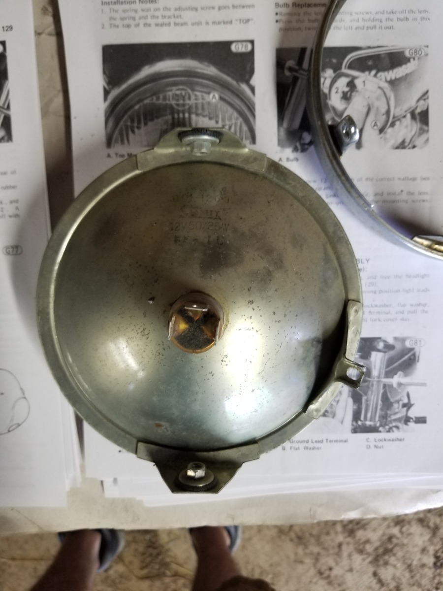

Okay so here's another good question - found a part number for a sealed Sylvania bulb in another thread where the OP stated they were looking for something brighter than the stock incandescent for a 1981 kz440... Someone replied with a link to the same Sylvania bulb stating it dropped right in. Found one locally and took everything apart only to find that it doesn't fit. The new bulb is 7" while the old retaining ring around the front of the old bulb looks to be 6". Beyond that, the brackets on the back of the old bulb appear to be fixed to the body of what I can only assume is the original bulb.... So does anyone know anything about this or how the hell I'm supposed to get a decently bringht replacement in this bike? Picture shows the back of the old bulb

I was actually just looking at that thread - so if I'm looking at it correctly, I can throw any 7" unit in that bucket / bracket combo and the top/bottom/horizontal adjusting brackets are on their own ring, which I would fit around the 7" unit I choose? Theoretically that would open me up to any of the DOT 7" led units on eBay?
