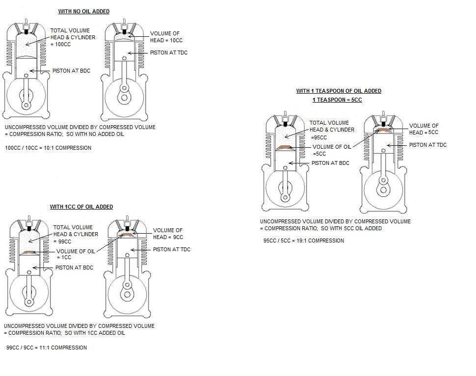

Now getting 135,150,150,135. All I did this evening was drain out the fully synthetic 10w40 I had in during rebuild, and put in mineral 10w40 for first run in later this week. Put a teaspoon down each plug hole to coat new rings with mineral oil and suddenly getting higher compression. Must be more viscous. Will update in next week or two after I reassemble the vm28 pumper carbs and fit and block the fuel injector ports. Fingers crossed for a firing engine that I practically pulled out of a ditch for €250 in Ireland :)

Consider the following..........
