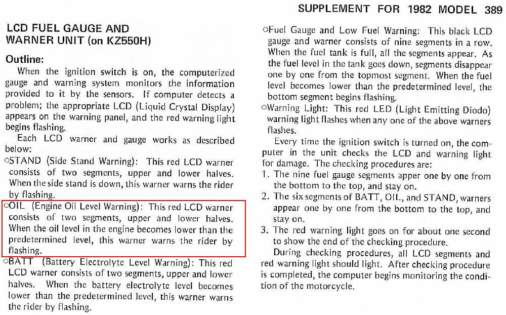

Re: 82 GPZ 550 Loss of oil pressure after a drop
22 Apr 2020 14:09 - 22 Apr 2020 14:11
The Kz650 manual for an older bike is not what I would use to troubleshoot a Kz550H model.
The Kz550H uses an oil-level sensor and the photo he provided shows the oil-level sensor.
It is very different from the Kz550 oil pressure sensor, which is why the oil pans are so different as detailed in the earlier link.

23 Apr 2020 03:26loudhvx wrote: The Kz650 manual for an older bike is not what I would use to troubleshoot a Kz550H model.
I had read this. I have that manual and, trust me, my nose hasn't been up the book this much since college days.
So, manual says it is a LEVEL switch, right?
Ok. I have some ideas what is going on.
