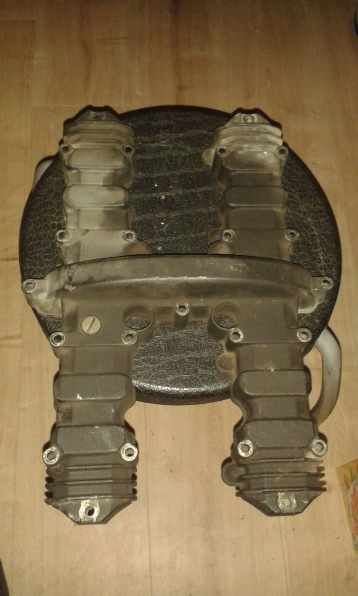

24 Jan 2020 17:03wera90ex wrote:
I bet your selling them for more than $40.
I am selling them to the same price i had payed for them plus shipping to the USA, 60-80 Euro dependent of the condition shipped, I am not greedy for Money!!!
If you or other want a non Smog valve cover i will do my best for you.

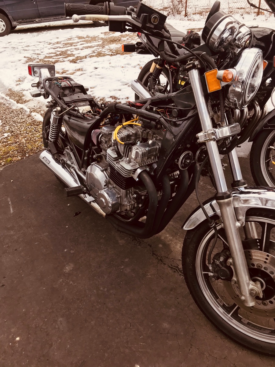

1982 KZ1100-A2/1170 sleeper 😀
