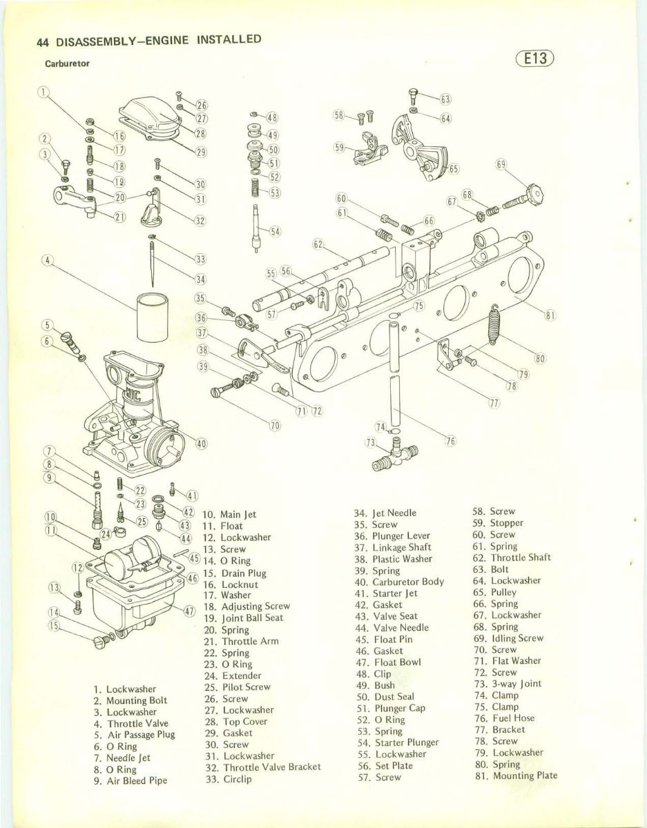

Re: '83 KZ650 / #3 will not fire?
18 Aug 2019 14:05
Before you put all carb parts together again check your air bleeder tubes, (#9 in the diagram) for clogged passage.
