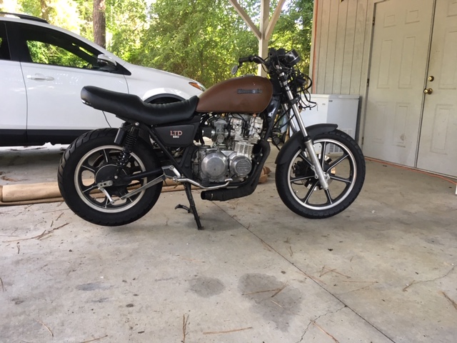

Whoa whoa whoa! Sorry to offend gents. Wife had our firstborn on the 20th of June and I haven't been in the garage since! I appreciate all of the input and will update when the little tike is old enough for day care and dad can get back in the shop without a baby monitor and paranoia. In the days prior to becoming pop, I was able to tension the cable enough with the adjustments alone to eliminate the initial issue; but the bar and in-line adjustments have to be MAXED out. Then the clutch was slipping at high revs. Then I became a dad. My plan is to change the oil first and fill to an appropriate level. I used SAE 10w-40 (castrol, high mileage, some sludge protectors which I understand can cause slippage). Then I plan on going back and trying the clutch screw adjustment tricks loudhvx recommended to see if this lessens the amount of cable tension required for clutch actuation. This bike has 18k on the current clutch pack so I figure replacing that will be the following step if all else fails. And for this, a mechanic will be involved. Also, I've attached a picture of the old girl for those who care.

]Congratulations Dad! That's awesome!
Thanks for the reply and photos... Now back to diaper duty
