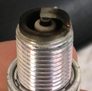

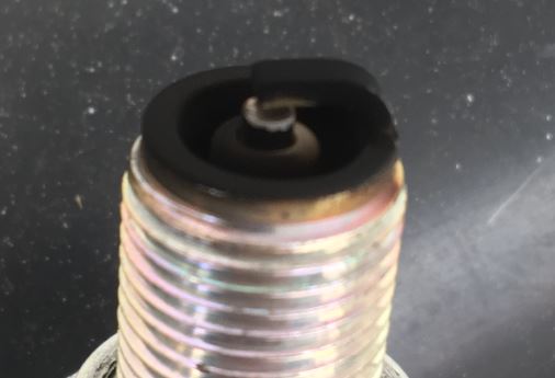

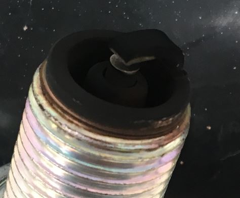

Yesterday I used the color tune to adjust the idle mix screw.
I adjusted idle approx. 2000 rpm and then I adjused the screw to full blue colour and turned slow back in until I could see some (tried to find the point where I saw yellow for the first time) yellow colour...

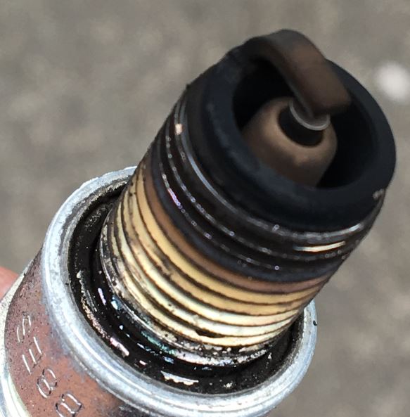

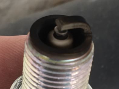

I took picture of the spark plugs before I tunned:
Cylinder 1:
Cylinder 2:
Cylinder 3:
Cylinder 4:
Cylinder 1:
Cylinder 2:
Cylinder 3:
Cylinder 4:

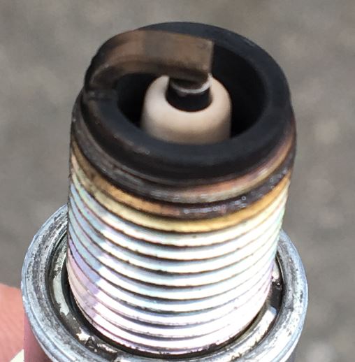

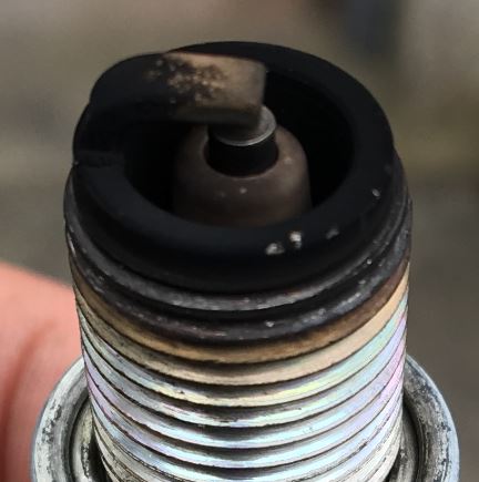

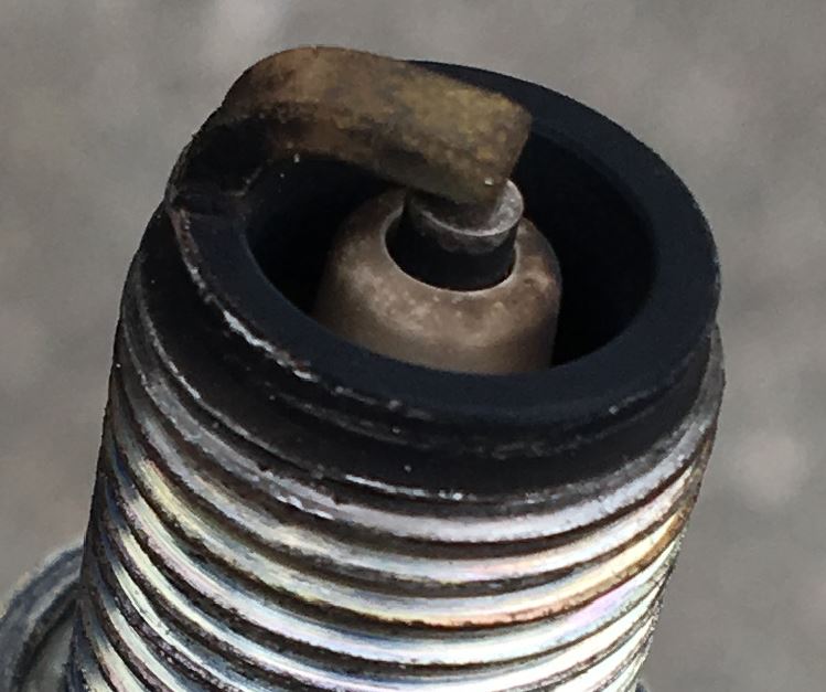

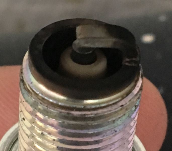

After the tunning was I installing new spark plugs and drive a tour for 62 miles and in the end of the trip it was some traffic jam.. so I was on idle for a while... rest of the trip (before end of the trip) was in 60-90km/h range.
Before taken after the trip:
Cylinder 1:
Cylinder 2:
Cylinder 3:
Cylinder 4:
Cylinder 1:
Cylinder 2:
Cylinder 3:
Cylinder 4:

What do you think?
Is the jets and pilot screw good now?
The bike is good to drive in whole range driving !

Re: Colourtune and spark plug condition
26 May 2019 09:45
I was driving in high speed before i took out the plug before the tuning...
Start to get tired of these....
How bad is it?
Try to screw all four in 1/4 turn and install new sparks?
How bad is it?

Screwing in will make them worse. In for less air, out for more. What the mixture screw does is block the air passage. I would turn them out 1/4 then check again.
Colourtunes are good if you have some experience with them. From your description it sounds right but you had just a tad too miuch orange.

Will try go out 1/4, how fare must I drive, all range of speed and throotle?

Colourtune can only set the pilot circuit which to be fair is about 60 or 70% of most peoples riding. Your can not check high revs with a colourtune as they are not strong enough and the last thing you want to do is have one break whilst your looking into it. The clear partion is glass and will shatter.
So to answer your question go fo a ride without going over 3 or 4k rpm then check your plugs. If good then go for another ride trying to keep the revs above that then check your plugs again. This second check will tell how your main jet and needle jet are performing.

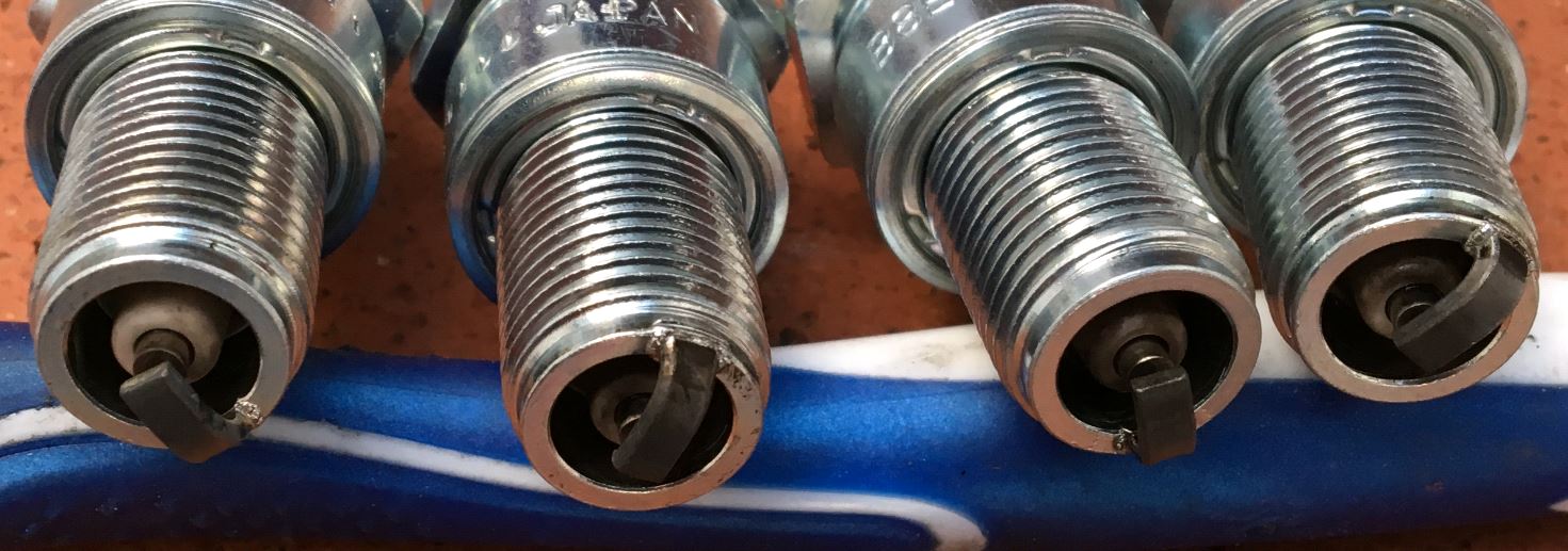

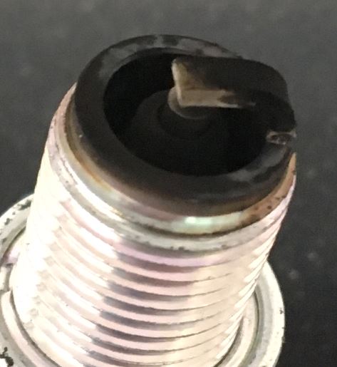

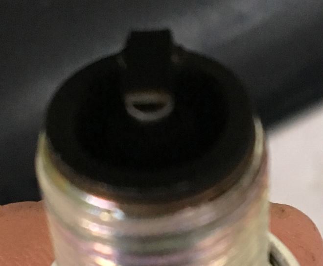

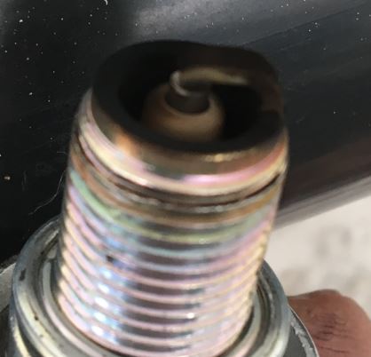

Today have I driven back and forth to job (10km * 2) 80% is on the highway so I have been close to the 3 rpm rest have I tried to be closer to 2 rpm.
I took out the spark plug when I come home, please see photo below:
Cylinder1:
Cylinder2:
Cylinder3:
Cylinder4:
I have cleaned the plug and installed them again:
I have adjusted all carb accept the one on cylinder 4, think that is good enough?
Cylinder 1 = 1/4+ out
Cylinder 2 = 1/8+ out
Cylinder 3 = 1/4+ out
Cylinder 4 = nothing
Cylinder1:
Cylinder2:
Cylinder3:
Cylinder4:
