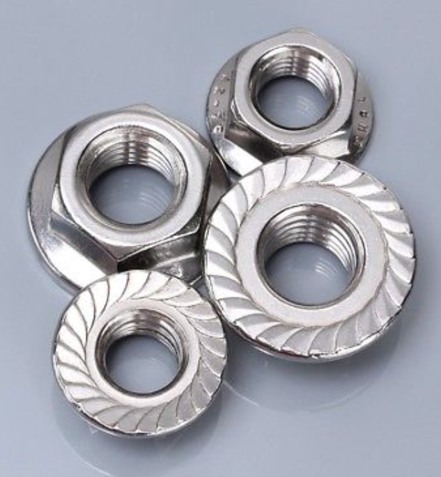

02 May 2019 14:17Thank you, but I think the nuts I have shall be good?

That's what I'm using.

I use the same but find that on stainless collars like delkevic they need a lock or shake washer as they can't bite into the surface but on standard aluminium collars like oems they are fine on their own.

Maybe it get friction because of the ceramic coating? I will keep and eye on it.
