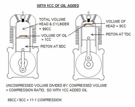

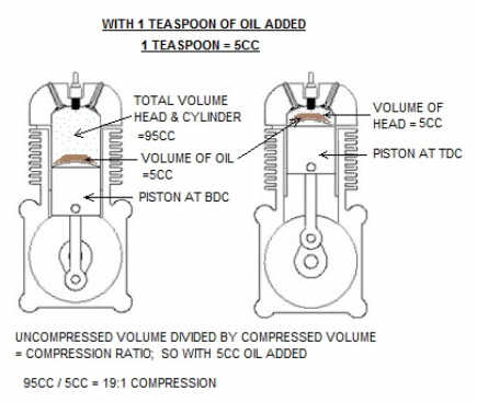

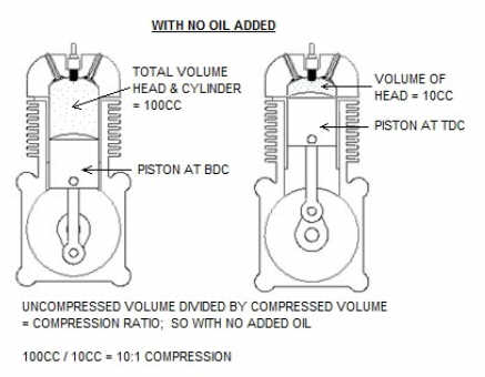

Yes, that's true mathematically, and if too much oil is used then the results can be skewed, hence not very useful. I've done the math for this engine below.
In this case this engine design compression ratio is 8.5/1. Bore and stroke are 78 mm. Doing the math gives a total piston volume displacement of 373 cc in one cylinder. The head volume at TDC (at 8.5/1) would be about 44 cc. (This assumes no carbon buildup) Assuming all of the oil stays on top of the piston the new compression ratio would be 378/39, or 9.7
It's also worthwhile to point out that what's shown in the diagrams is only a single piston cycle where the oil remains on top of the piston, displacing head volume. During an actual compression test the cylinder will go through 10 to 15 or more complete cycles. (The engine is cranked over until the pressure gauge no longer shows an increase.) During this time the oil will spread to the cylinder walls and coat them, causing an increase in compression if the rings are in poor shape.
Compression for 4 mm on top of the piston would be 377/40 = 9.4. For 3 mm would be 376/41 = 9.2. For 2 mm would be 375/42 = 8.9. For one mm would be 374/43 = 8.7
It's important to keep in mind that the test isn't done to determine the actual engine compression. It's to compare two readings to see if there is a significant difference between the two tests that would indicate whether low compression is due to rings or to valves.
