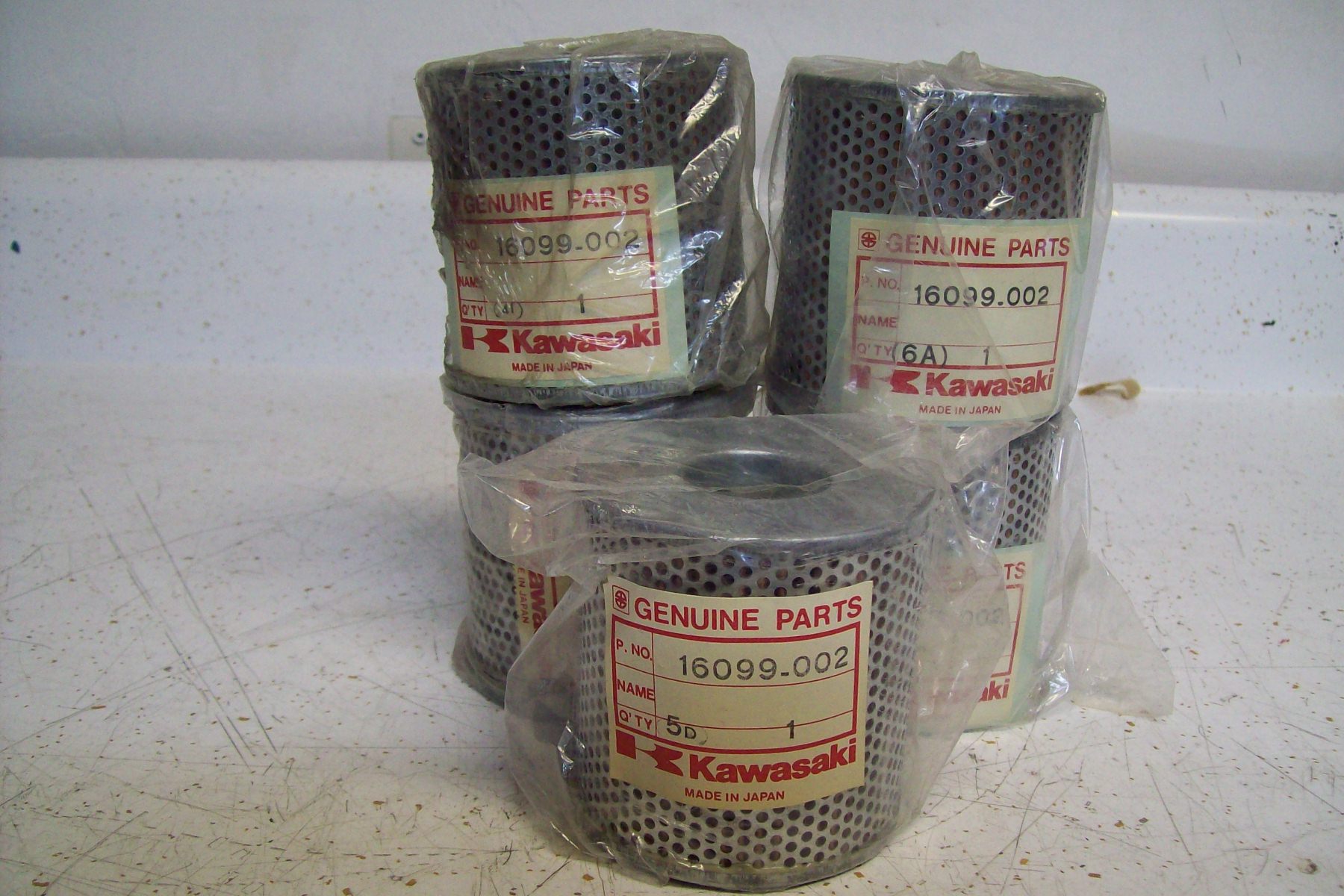

15 Jan 2019 20:57zed1015 wrote:Non of the 903/1015 motors had them, just the later 'J' type motors (non kickstart ) and the 650 etc.hardrockminer wrote: I've never seen a filter cover like that one on a Z1 or KZ1015. Did it come with the bike like that new?
I've never owned a bike that new so I didn't know.

15 Jan 2019 23:19 - 15 Jan 2019 23:22SWest wrote: Why are they there? Steve
Interesting question, Steve. My guess would be something like a windage tray / barrier from all of the spinning parts? Another questioon might be why the Z1 1015 filters have a metal cage? Possibly the same reason.

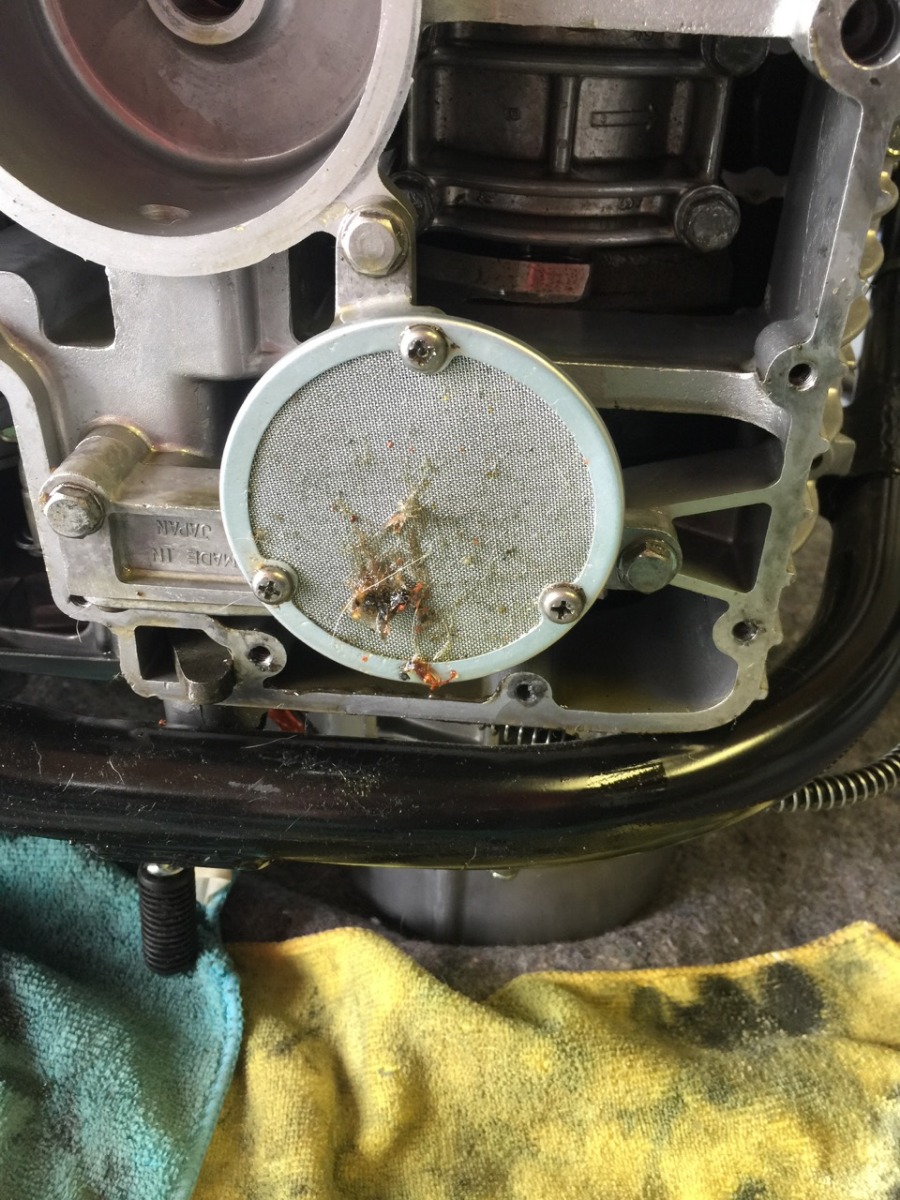

I recently rebuilt a Z1 engine. After running it for about 10 minutes I dropped the oil pan to check the kickshaft. The photo below is was the oil strainer caught in only 10 minutes of run time.

19 Jan 2019 08:32bet that spider had a big surpriseThe photo below is was the oil strainer caught in only 10 minutes of run time.
