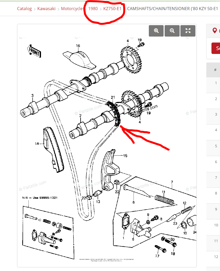

KZB2 650 wrote: The 1980 KZ750 uses the regular chain and not the hyvo ........ why you need that block for a 810 or 831cc kit for your 650.
Incorrect. ALL 750/4's use the link plate hyvo type chain.
- Posts: 15344
- Thank you received: 2829
Nessism wrote: .............. ALL 750/4's use the link plate hyvo type chain.
Correct! If there's any doubt just look at pages 54 & 55 of the Kawasaki Service Manual provided by KZRider (link below). Ed

www.kawasaki.com/Parts/PartsDiagram/144037/1980/KZ750-G1
Here's one on ebay, clearly a roller chain (for the 750 twins).

KZB2 650 wrote: Always remembered reading you needed a 1980 750 block to have the right cutouts for the reg chain set up used on the 77-78 KZ650s to go with the 810 cc kit so I always thought it used the reg chain too but was wrong. I see the # is 1054 for the 1980 block and 1062 for the 81-82 but the picture shows the cutouts being the same so maybe that info was wrong too.
I don't think it's "only" the 1980 cylinder that had the cutouts, at least some 1981 and maybe even later engines had them too. If you think that's confusing try studying head gasket part numbers some time. In theory the 650 and at least some 750's share the same gasket, but you won't find a clear supercession chain anywhere.
