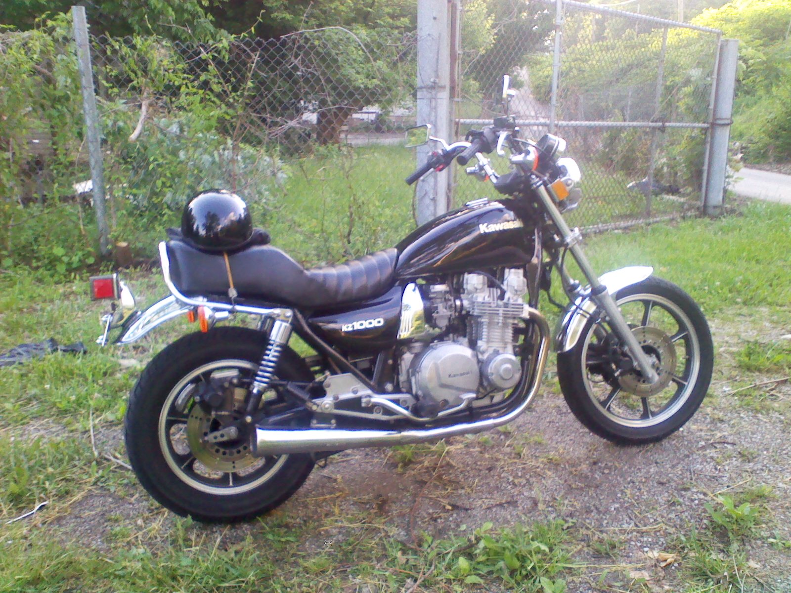

Thanks for all of the great replies stories and explanations to this newbie in the art of modifying these engines, and the pitfalls thereof. I am glad that I already lived through my "hot rod racing" days, because my bike is extremely reliable AND fast. I get in enough trouble as it is. it starts every time, makes it home under it's own power, and runs like a bat outa hell.
I did make one observation throughout this thread.. it would seem that "spitting a shim" kinda turns the go fast parts into go slow parts with a hole in your head as a bonus.
Pushing it home is no fun.
Stock works for me.
Not really lacking power anyway. Note: I did not burn off this tire on purpose like the loud and slow crowd, that's from cranking the throttle.
