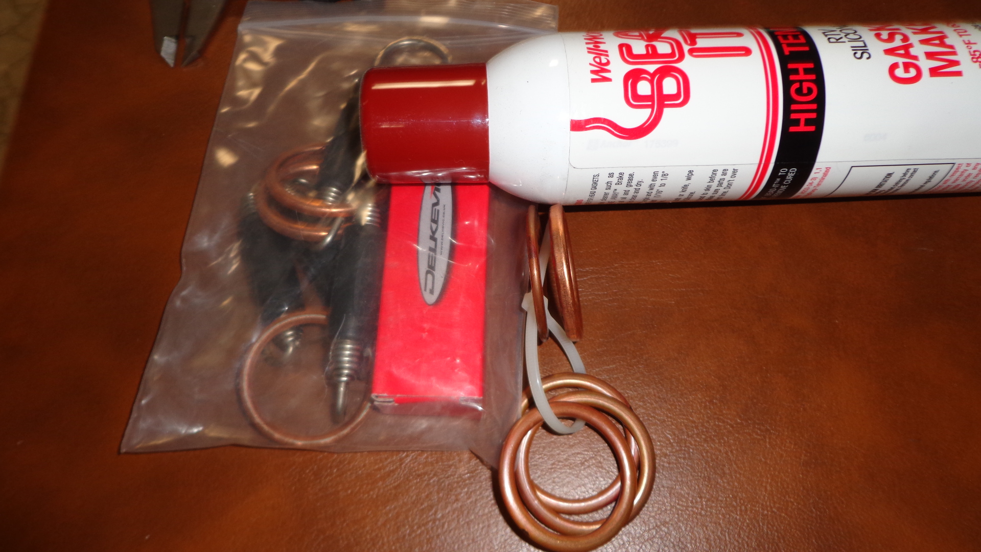

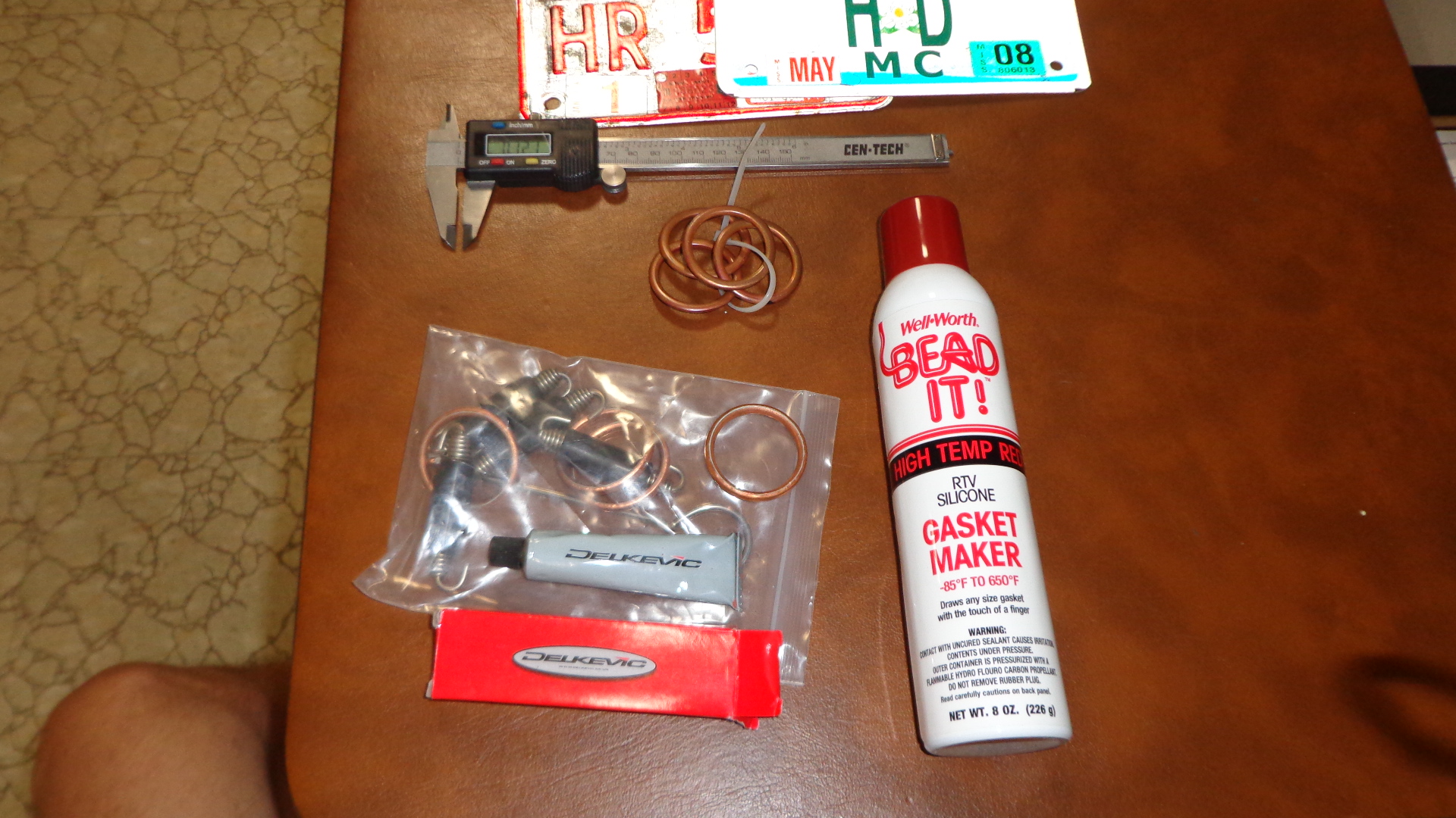

1st of all, new DELKEVIC exhausts come with their brand of copper crush washer. They are .171" thick.
Stock aftermarket cheap crap on net for Kaws are .120" thick.
Plus Delkevic supplies silicone RTV for sealing also.
Delk; does not need collars!
ME: I have been using red high temp RTV, since it came out 25 years ago for sealing exhaust pipes. My old Shovelhead has never had a gasket on it's exhaust. That cheap old Harley design with 1 - ]5/16" bolt?. I use RTV on them. Have for years.
Plus if you crush down a washer, get a new one!
Or on the cheap, seal it up with RTV silicone!
Don't know what size your exhaust studs are? But be careful with the early 6mm studs.
