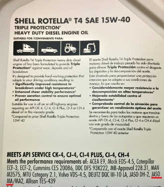

I don't disagree with your points, but for anyone not familiar with the ingredients in motor oils the easiest and maybe safest bet is to stick with oils that have JASO-MA on the label. Regarding diesel motor oil - Shell Rotella T4 has been tested to meet JASO-MA standards and is sold at most auto stores at a reasonable price, so it is not a bad choice. Ed

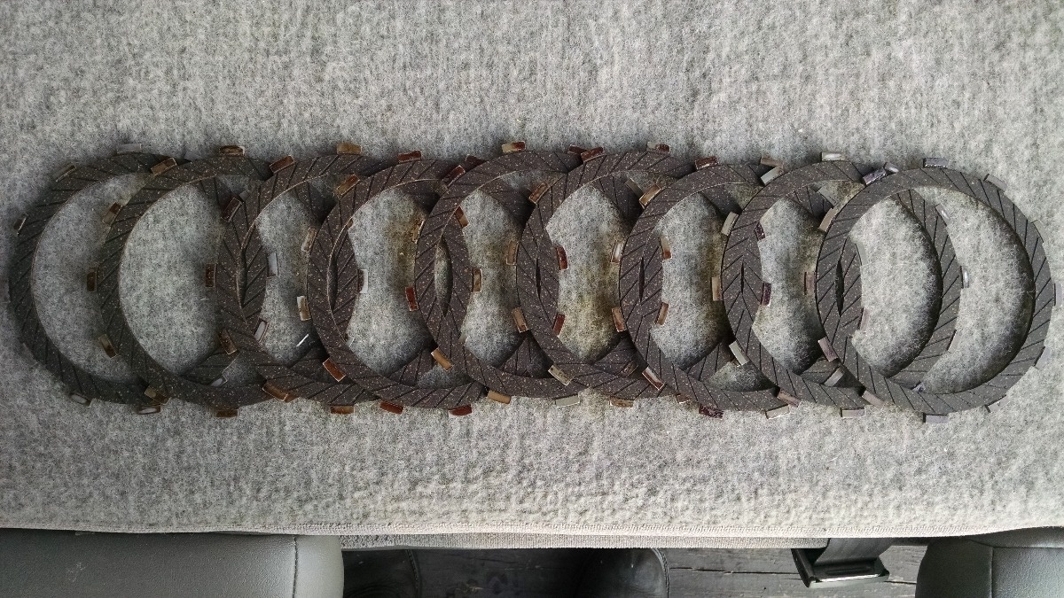

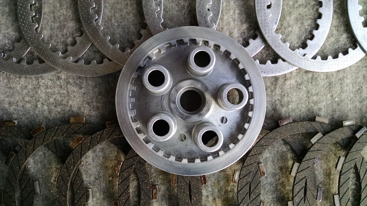

This is a great article and this man obviously did his homework with checking spring weights and trying different springs. I have not read it lately (6 months ago), so read up and learn all about clutches, oils, springs and cleaning up the clutch plates after contamination.
kzrider.com/forum/2-engine/367700-refurbishing-your-clutch
This pic is after I soaked the plates in the ZEP citrus degreaser for ~ an hour, then did a light scuffing with scotchbrite.
