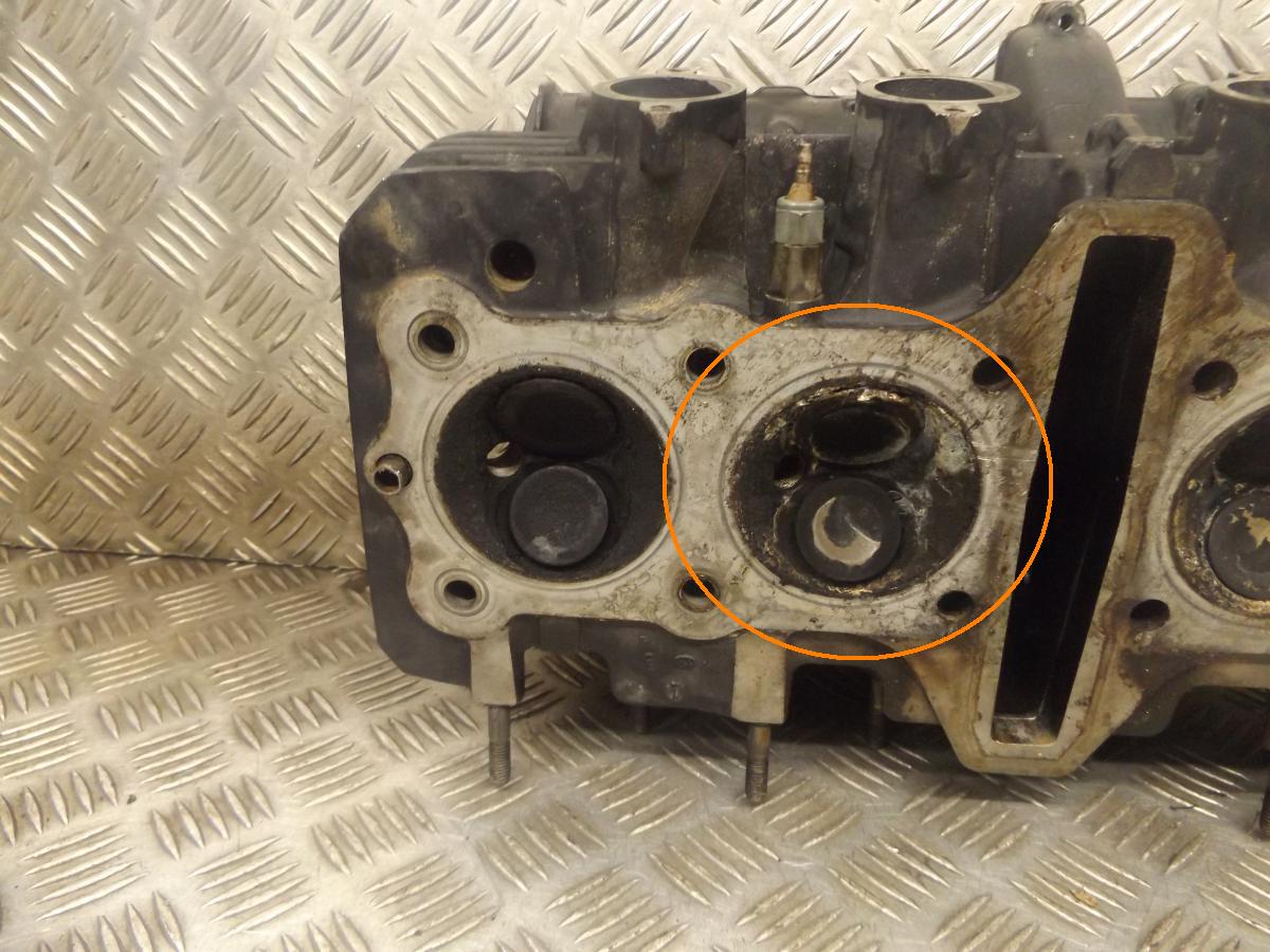

Observe closely the #2 intake valve and adjacent area of the chamber:

The 2 "panels" you refer to are one way reed valve chambers in the camcover for the US emmisions system and are not part of the actual head.
Plain UK etc covers without the "panels" bolt straight on.
The combustion chamber of the Unitrack/1100r head differs from the plain hemispherical of ALL the others.
It is a different shape usually called a Twin swirl .
The have been nicknamed "Bathtub" due to the elongated recess which surrounds the valves which vaguely resembles a bath or figure of 8.
Also on the Unitrack there is a letter "A" stamped in the mouth of each of the inlet tracts.
As Daveo has spotted it looks like there is an issue with 2 inlet valve but I doubt that any damage extends to the seat.
A new valve or one "borrowed" from your own head should sort that out.
If you are close enough to DK it would be worth giving them a visit to see the head in person or at least ask them some questions in Ebay messages about the valve.
Whatever you do, don't mention that it is actually a Unitrack/1100r head as they will cancel the listing and re-advertise at a much higher price.
You will notice that the head is also BEST OFFER.
DK usually allow around 10% discount so i'd offer at least £50 less on the first bid and see what happens.

Thanks so Much, I will contact the buyer on Monday, not mentioning that its a GPz1100A head, your information is great to know I have learnt loads. I will just check there is only damage to a valve rather than the head being damaged, and offer a bid of say £225 and see what they say, I also need a Generator side case approx. £50 and Oil Cooler for about £50 so see what deal can be done on all 3 items.

Thanks for noticing that Daveo, all sounds like a good plan coming together.
I will check Damage as I mentioned in post bellow and post any news about this possible head purchase on this thread.
could be the end of my head troubles, once brought and the best parts from two heads refurbished as one working head by a specialist.
