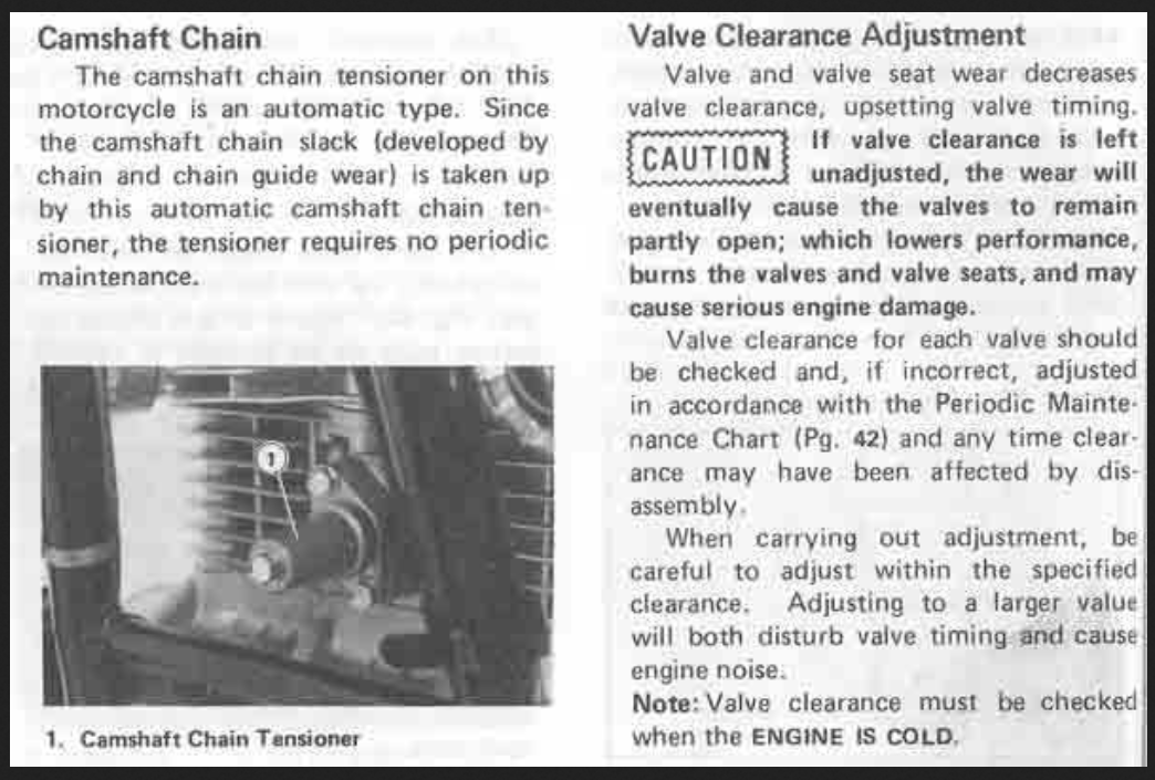

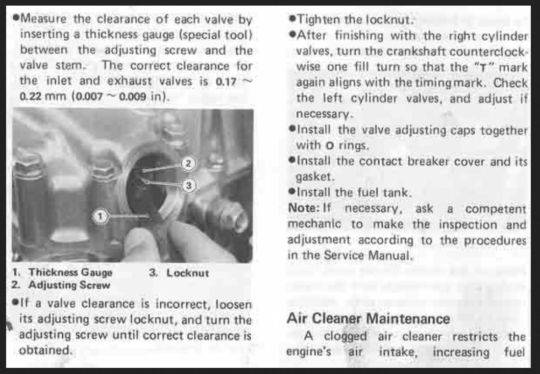

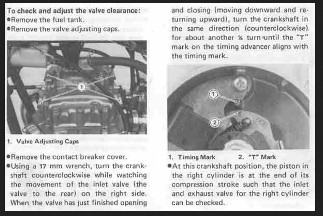

24 Apr 2016 00:28 - 24 Apr 2016 00:33jjsuf wrote: It did bog down with increased throttle, around 3.5rpm, but now it won't start. I'm looking into the valves, not quite sure how to check them though.
From the FSM
This and loads more good KZ400/440 info is also available at:
Click here > www.kz400.com/
The above pics may be located via menu path: > KZ440 Maintenance > Valve Clearance Adjustment
