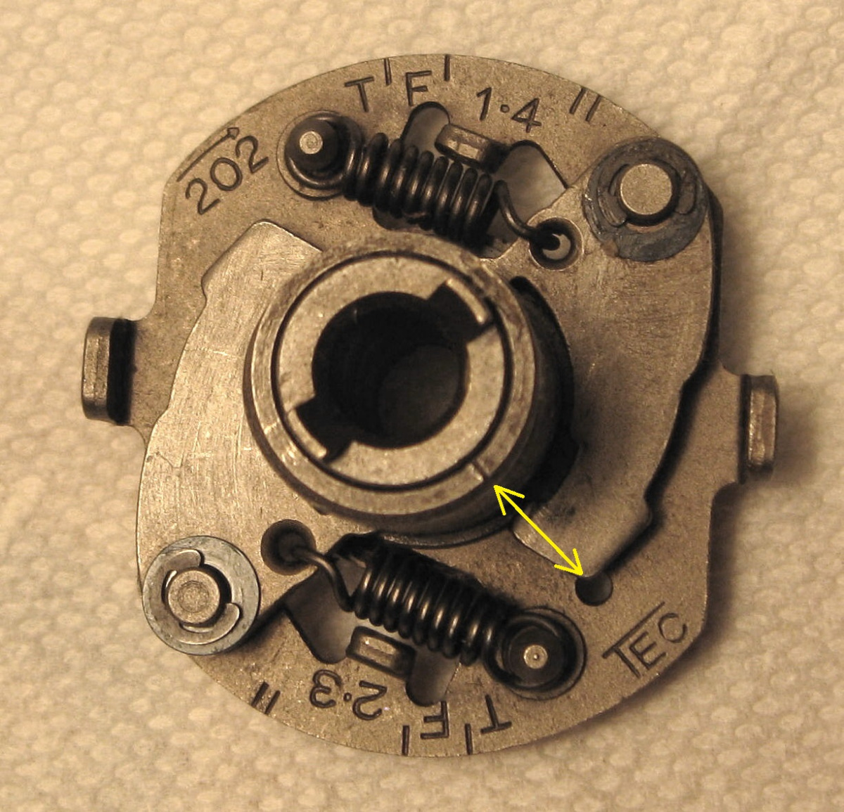

So I think I figured out part of my issue. Since I put the points system back on the I didn't check the cam and just put it in thinking it was like a four cylinder (an oval). So I read my manual but it only references the timing advancer from the 76' kz750 which is slightly different. Mine doesn't have the the cut out to clock the advancer came correctly. But it does have a little hole right next to the tec logo can anyone verify this is correct alignment? I provided the manual instructions and a pic of my advancer with it aligned as described. If that is correct then i would have had it 180 degrees out. no bueno

Here's a picture of my KZ650 timing advancer. It may be a little different than your advancer, but shows the hole and the mark on the cam. Ed

THANKS ED! yes that is what i was talking about which means mine must have been 180 degrees out. thanks!

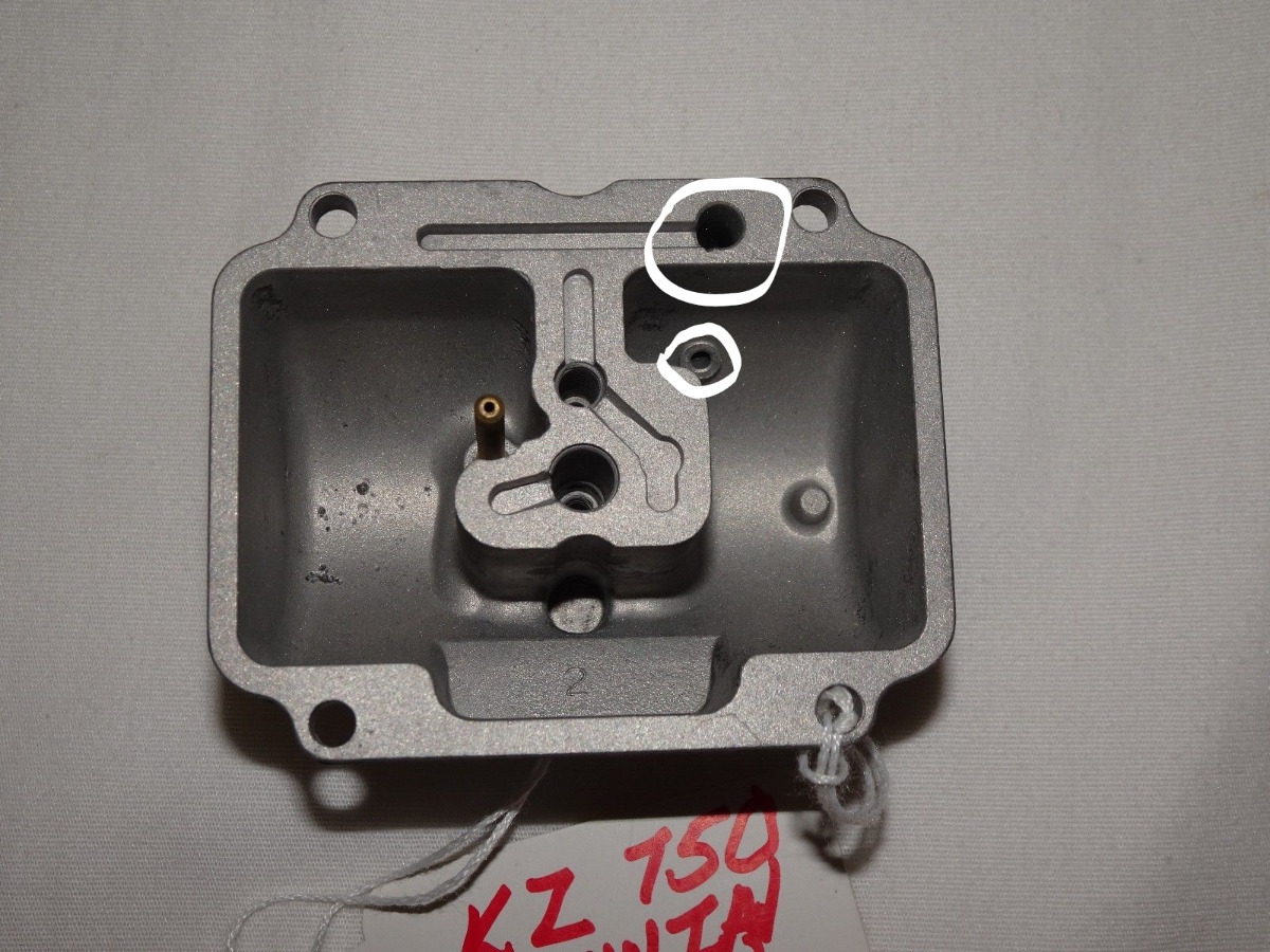

The jet which will make it extremely hard to start if blocked is the one at the bottom of the top circled hole these are push in, and sometimes when a bike has sat idle for long periods and the fuel has evaporated they are gummed up with residual varnish, these need to be clear or you will have no fuel when operating the choke.
