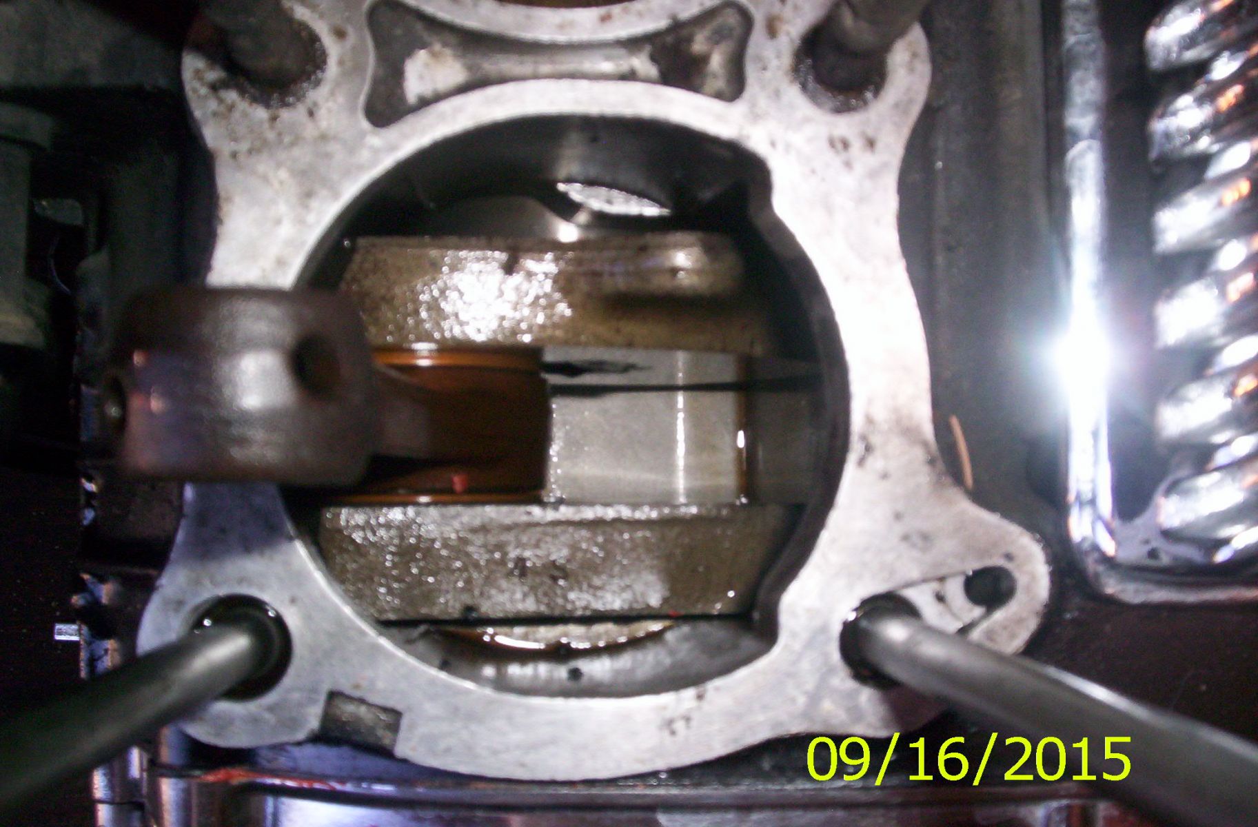

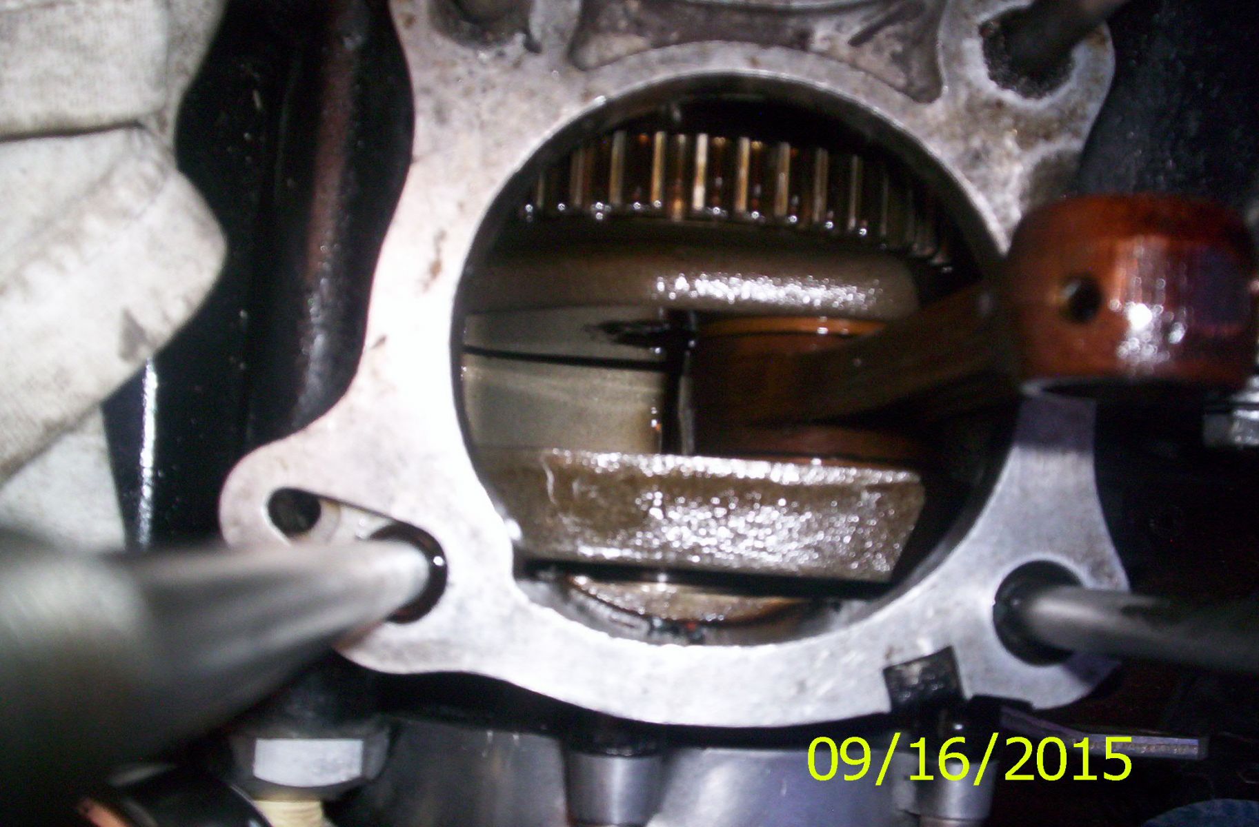

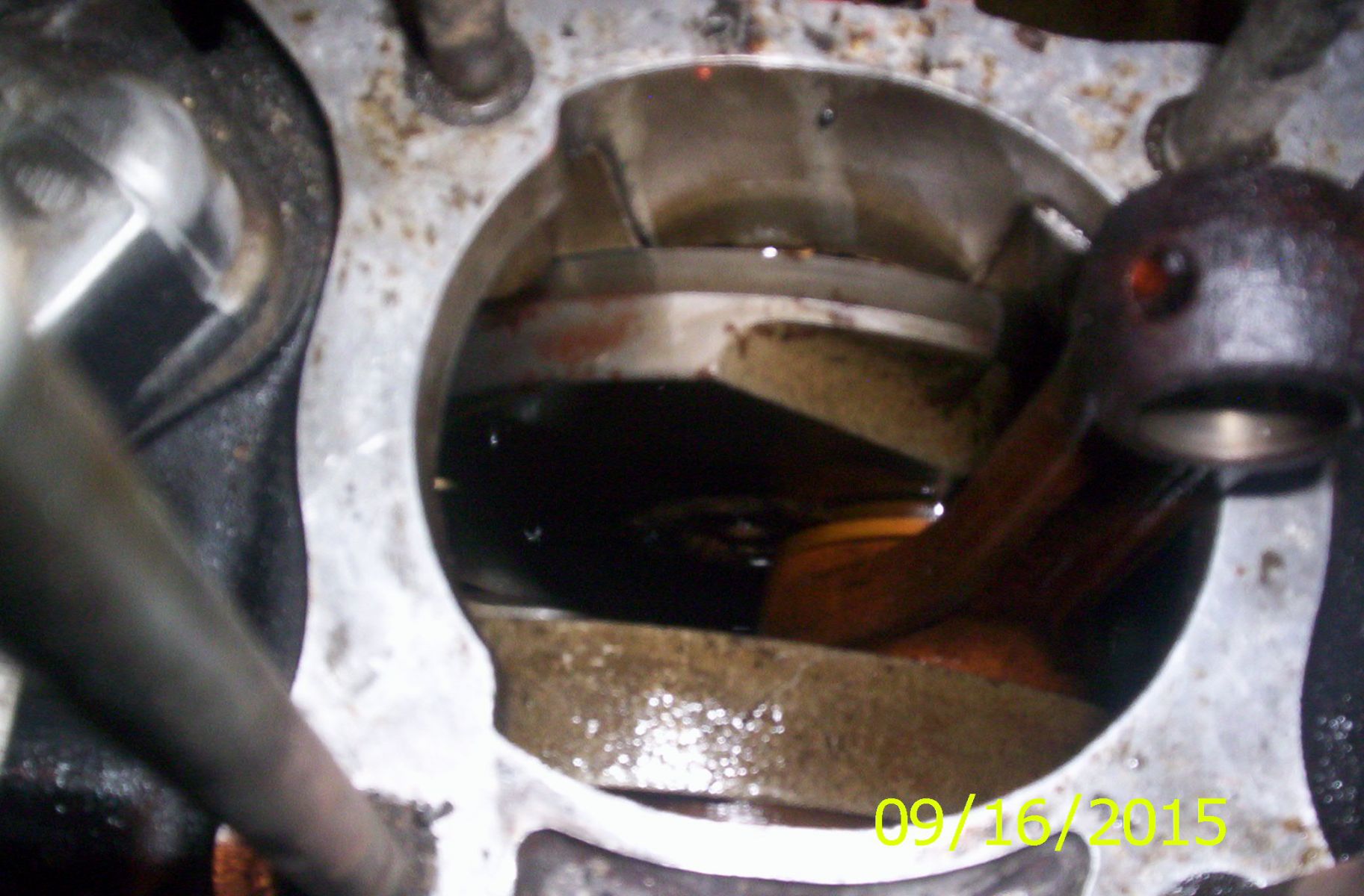

The crank has been removed and as you can see the two centre webs are way out from each other
I now have the Z900 crank in, the crank has not been welded but it has been checked / trued. The mechanics around Perth suggested to leave the crank unwelded for street use.
