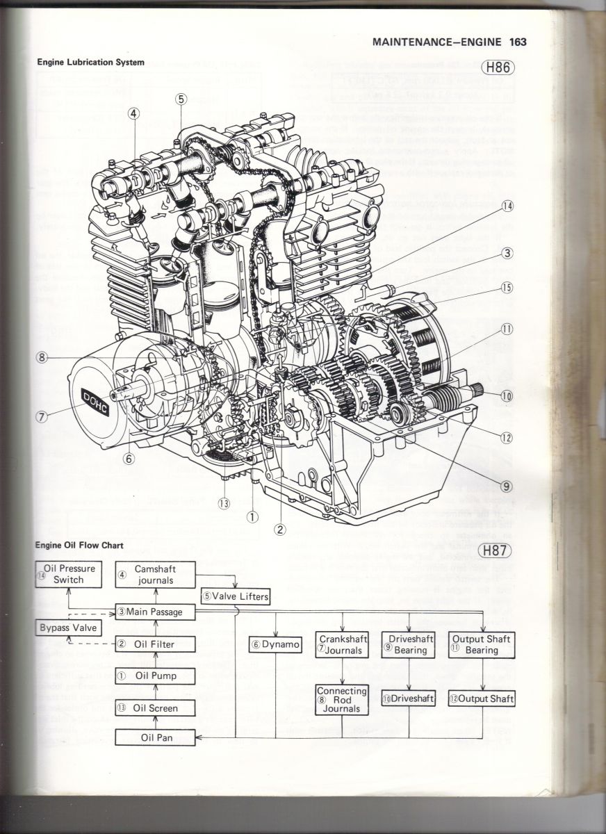

On the large fours with needle bearing cranks, there's not quite so much danger from low oil pressure at ultra-low idle. Because the oil pressure is minimal anyhow, and the needle bearings and cam journals just need a some oil bath as opposed to significant pressure required by surface-to-surface crank bearings in the smaller engines such as KZ650.
In any event, would set the idle per factory specs.
