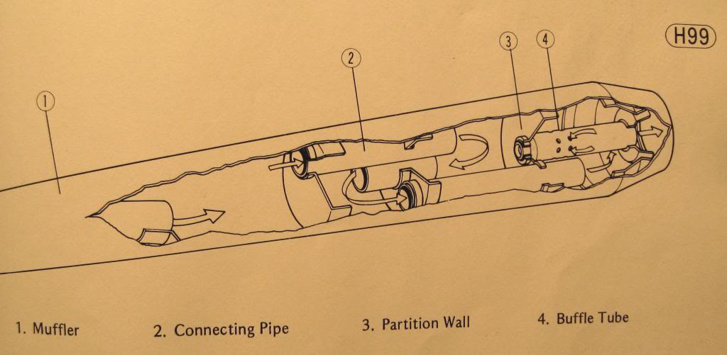

Bike looks great! In reading your thread it sounds like the exhaust system that failed wasn't actually the stock system since there appears to be no way for the baffle to fall out (unless maybe there was severe rust or maybe a PO modified it?). Can you post a picture of the problem area on the old exhaust? Just curious.
Here's how the original mufflers are constructed. Ed

Your observation is right Ed. The pipe had the stock header, crossover cut out and welded. The cans on there are not reverse cone and were also welded on. The baffle that broke out was a single tube center position baffle. I will take some pics. My thought is to die grind out the baffles and find an aftermarket baffle insert that fits, 2 1/2" canisters. I would like to have the 2-1 stock look, but we'll see. the Delkevic performs well and I like the look so this will not be an imminent project, but perhaps re-chromed or blasted and black might be a good preservation idea. R
