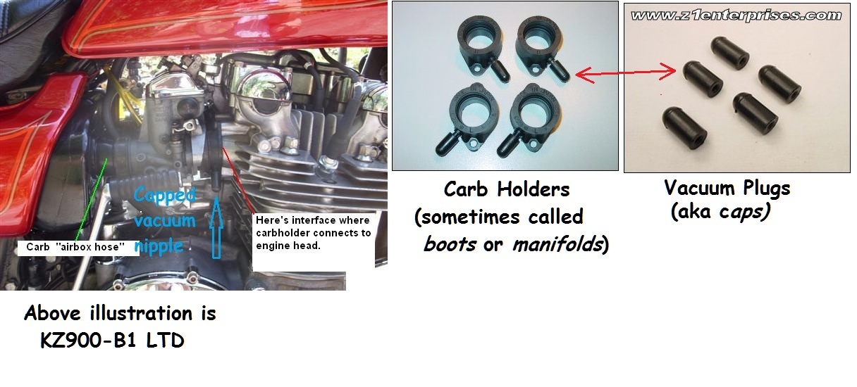

Would also assure integrity of the rubber caps (aka plugs) that cover and supposedly seal the four vacuum nipples on the four carb holders.
If one or more of the plugs is defective or missing, it creates a major vacuum leak.

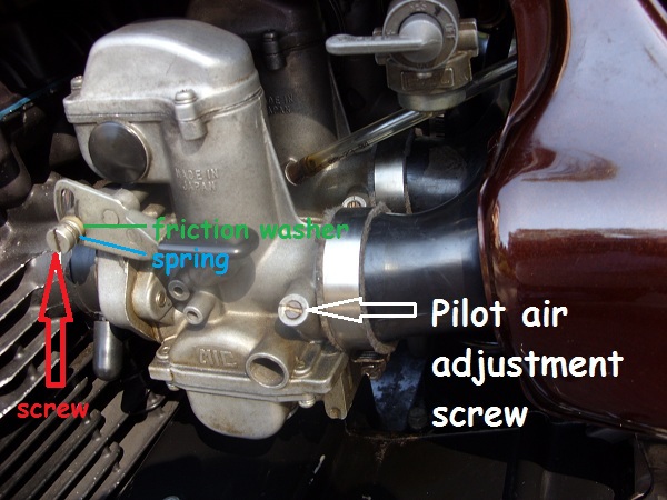

26 Jan 2015 07:35 - 26 Jan 2015 07:49Grumpy Ole Artist wrote: ... during normal operation, at startup on full choke...will rev like a sonofagun (depending on ambient temps) a few seconds after initial firing unless I progressively lower the choke....
Same here.
If not already done, kzdcw should assure that the choke is fully shut off -- choke lever pushed completely down -- and that the choke lever is staying down and not lifting on its own accord due to whatever reason such as engine vibration.
There should be screw with a friction washer that helps toward holding the choke lever in position.
Here's a similar example.
