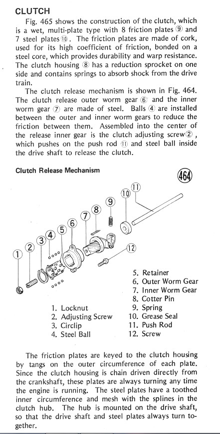

The oil is fresh from when I pulled the plates last week. I am still going to look into the bearing and shift mechanism just to be sure. So I'm on the same page, the bearing you're referring to is the one in the photo below.

The oil is not your problem. Your symptom is the clutch won't disengage (drags). If anything, the API oil will cause the clutch to not engage (slip).
If you feel resistance at the cable, the ball is also probably there. The lever would have lots of free play if the ball was missing.
Remove the cover and check 2 things. First, when you pull the clutch, you should be able to see the clutch hub move. It's not much, but it will move outward. Next, remove the clutch plates and inspect the "fingers" of the clutch basket for grooves. The fiber plate tabs wear notches or grooves in the basket fingers. The plates get caught in these grooves and will not release. You can remove the grooves by lightly filling each finger of the clutch basket.

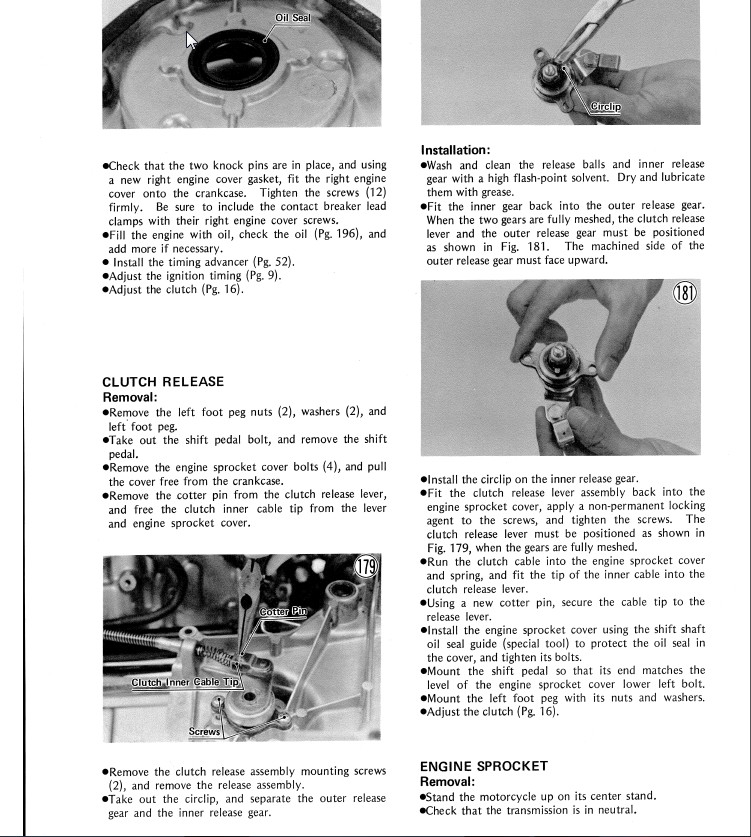

Thanks for the input MDZ. I ran through everything you suggested. It's been a while so let's recap.
I am having a clutch disengagement issue. It won't happen! Apologies for the misleading title of my post.
The clutch release unit is fine and in working order. There is tension when I make adjustments at any of the many points. Lever, midway adjustment nut and clutch adjustment screw. See attached images.
I inspected the clutch basket. There is movement when I pull the Clutch lever. It's not much but what I would expect there to be. I removed the plates and inspected them. I am new but they appear to be fine. No burn marks from friction, or any build up of material. I went ahead and honed them as suggested from a few friends. Also oiled them before reinstall. (oil used Rotella-T 15-40)
I check the basket fingers and there is no visible wear. Even gave it a finger job. Everything felt good.
I pulled the push rod and bearing out and those look good too.... This is where I am at a blank. A friend just came to take a look and his response was not great. Slow step back "that's about all I know" He suggested I pull the whole clutch and reinstall. Or go to a mechanic. Not very excited about that idea.
If anyone has further suggestions or insight I'd appreciate the thoughts.
