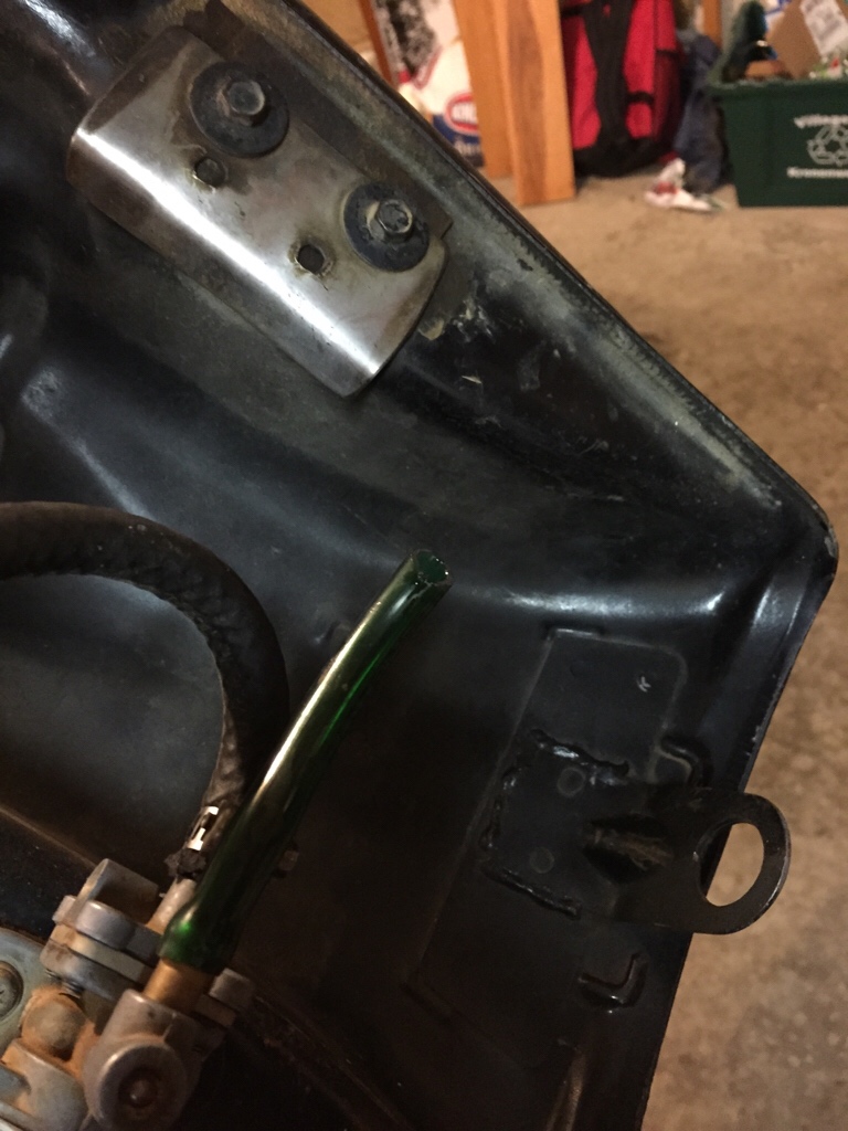

Another odd thing...the tank looks the same as my 550 and the frame where it mounts looks the same, but the little peg thingy that clips into the rubber mounting bracket at the seat side of the tank isn't on this tank...even though the place for it to buckle in is on the frame. Doesn't look like the tank has been modified, so the tank must be from a different model...

Also notice the PO moved the petcock to the fuel sensor hole and blanked off the original petcock hole....hmmm...
Ah ha! I knew that the tank off a 750 (used to have one) was the same more or less than the 550...but my dad had a 1980 440 LTD and the tank was about the same size - sure enough, I looked at the part diagram and it's a 440 tank I think. It has that prong with the big hole in it and the diagram shows a bolt attaching it to the frame... Sometimes trying to re-create the previous life of these bikes can make a guy feel like Sherlock holmes...

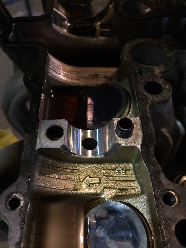

ok guys...last night I was able to start the bike up. Tonight I decided before I get any further with pulling the motor I'd take a peek at the valve clearances. Like some stated, w the low mileage it may not need it. wrong. Almost all the valves were out of tolerance, but at least they all had some gap... but there was 2 of them that had 0.06mm gap and the tolerance lower spec is 0.1mm. jeesh...glad I looked.
Anyway, now I gotta do some math and figure out which shims I need and try to find a place where I can just buy 1 shim and not a pack of 5...or better yet, a shop that will trade me with just a few dollar fee.
I did find some damage though... not sure what in the world caused this... but you can see on the journal in the head, the edge of the aluminum is cracked a bit. Not sign of any damage on the surface the cam rides on or on the cam, nor any aluminum kibbles laying around. Does this look like maybe someone didn't install a cam right and torqued it down or maybe was really rough taking it out? SInce its not on the surface much I'm hoping I can just smooth the rough edges out with some emery cloth and call it good.

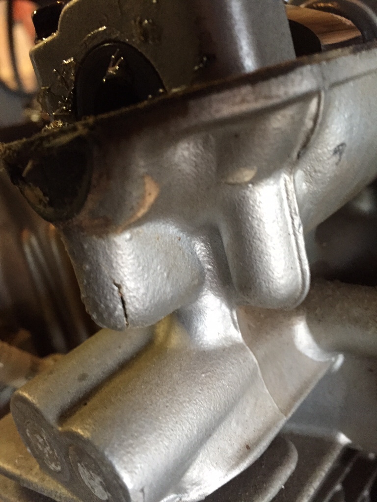

Also found an external crack... That appears to be someone used too long of a cam cover bolt... Hopefully just some jb weld or the like, some sanding and no harm no foul...

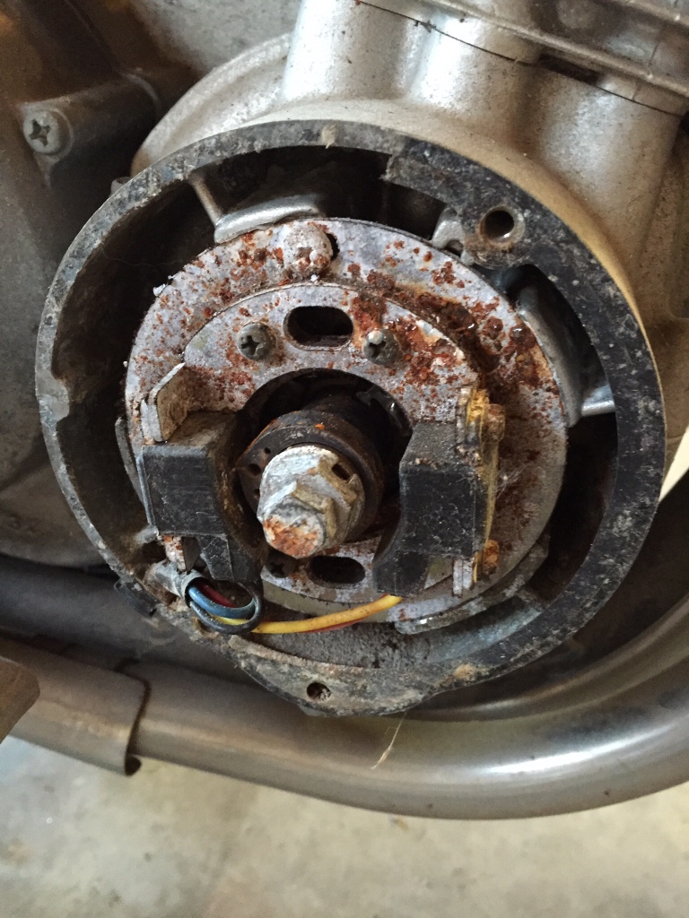

nice corroded pickup coil too... good thing I don't need it.

Can't say what caused it. But make sure to put the caps on in the right direction so the thrust surfaces are in the right place.
Make sure to clean out the bolt holes. Get all of the oil and sealant out of the holes before installing the valve cover. Not doing so is what causes threads to strip and maybe even that crack. If it's not leaking, I wouldn't worry about it until it does,
