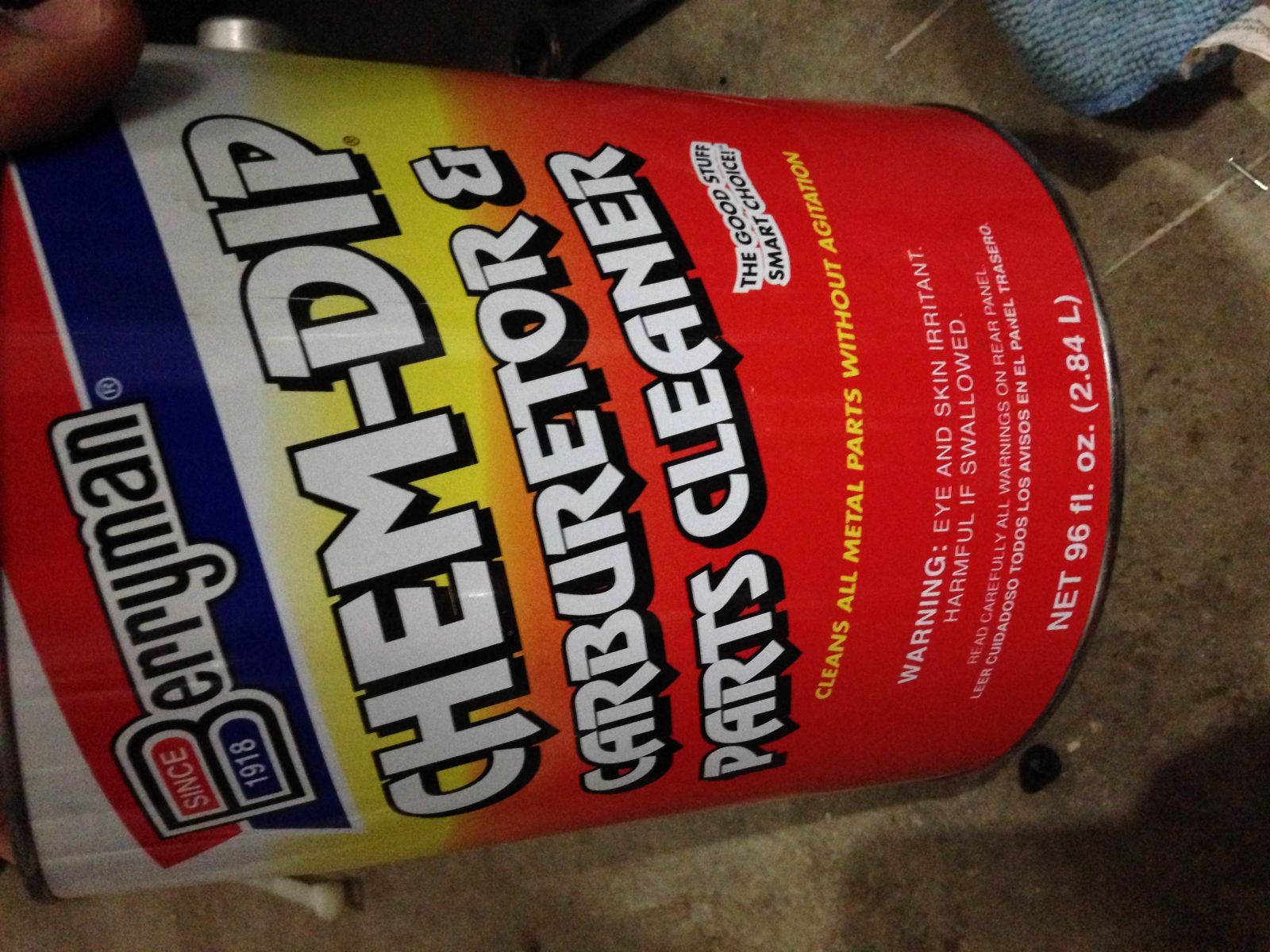

way to rich....strip down the carbs and clean them..
this is what i used......dip for 8 hrs each....dip in water to wash off cleaner then use compress air. make sure u get air through all passages.
auto zone $29
auto zone $29

OK, thanks man. Just checking... looks good.
Please understand why I asked,.. so many rinse them in the kitchen sink and think this is enuf! :laugh: Then, after I asked, I see you've been here for a while... so, my humble apologies if yourself, or anyone, took this question as a question of your abilities.

It is rare to have to completely dismantle the carbs and soak them. Not only is this a waste of time, if rubber parts are soaked, they'll be ruined. Carb spray is all that's needed most of the time, just don't hit the rubber or plastic parts. It ran for 8 or 10 miles with new plugs but fouled the plugs. Unless the plugs smell like gas, it's oil fouled. Time to pull the head and replace the seals and/or rings. If you decide to do this, report back with pics and we all can give informed advice.
