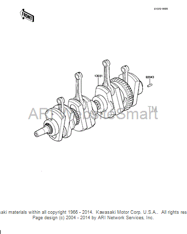

- PLUMMEN
- Posts: 7986
- Thanks: 104
Re: Worth the money to repair? please help
02 Sep 2014 18:43\saxjonz wrote: It could be the crank is slipping on the stator, like a sheered pin? Plummen?
Im not sure if its just a taper fit,or if the j series went back to a woodruff key.
