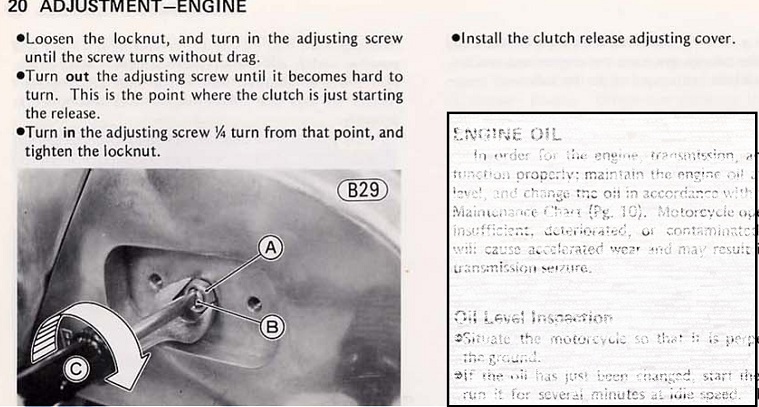

Perhaps there's excess gap in the clutch push-rod adjustment.

Patton wrote: Perhaps there's excess gap in the clutch push-rod adjustment.
If not already done ---
Good Fortune! :)
I saw this procedure in the manual but it seems this bike doesn't have this. Instead it's blocked off under that cover. I'll send a picture when I get off work.
*scratches head
Is there another adjustment I can make other than the 2 on the cable?
  • 650ed
  • 650ed's Avatar
  • Posts: 15333
  • Thanks: 2833
Re: 1981 kz440, changed the oil... now it wont start..
09 Sep 2014 11:21
#646864
You need to sort out why the clutch adjustment screw and locknut are missing. They are needed to adjust the clutch. Pictures will be interesting to see. Ed
  • KzHeadach
  • KzHeadach's Avatar Topic Author
  • Posts: 26
  • Thanks: 0
09 Sep 2014 16:44
#646912
I havnt pulled that plug out yet but this plug lines up with the hole that the clutch push rod adjustment should be... I havnt removed anything in this area other than the covers
  • 650ed
  • 650ed's Avatar
  • Posts: 15333
  • Thanks: 2833
09 Sep 2014 16:51 - 09 Sep 2014 16:57
#646913
Hold on - yours is a 1981 belt drive, so if it is a D3 not a D2 it may have a different clutch arrangement! Look for something like what is shown in the diagram below. Also, take a look at the manual in the link below, especially starting at page 300. Ed
www.kz400.com/Workshop%20manual%20bilder...Service%20Manual.pdf
