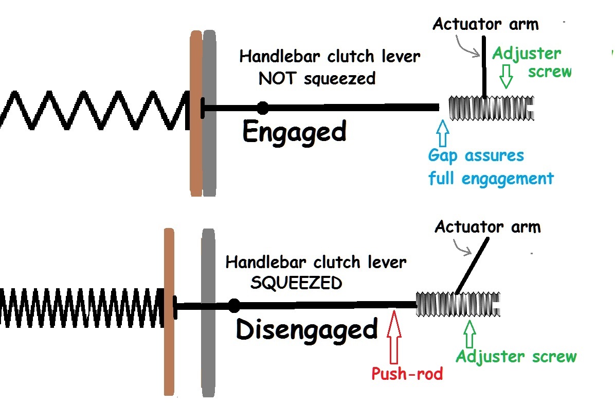

The clutch activation mechanism may have been pushed beyond its limit, and rendered inoperable. Am thinking, but not positive, that the over-extended mechanism may be restored to serviceable condition.
It's sometimes confusing as to which way the clutch push-rod adjusting screw is turned so as to seat it against the push rod before next turning it in the opposite direction 1/4 turn in order to create the necessary gap between the screw and the push-rod.
