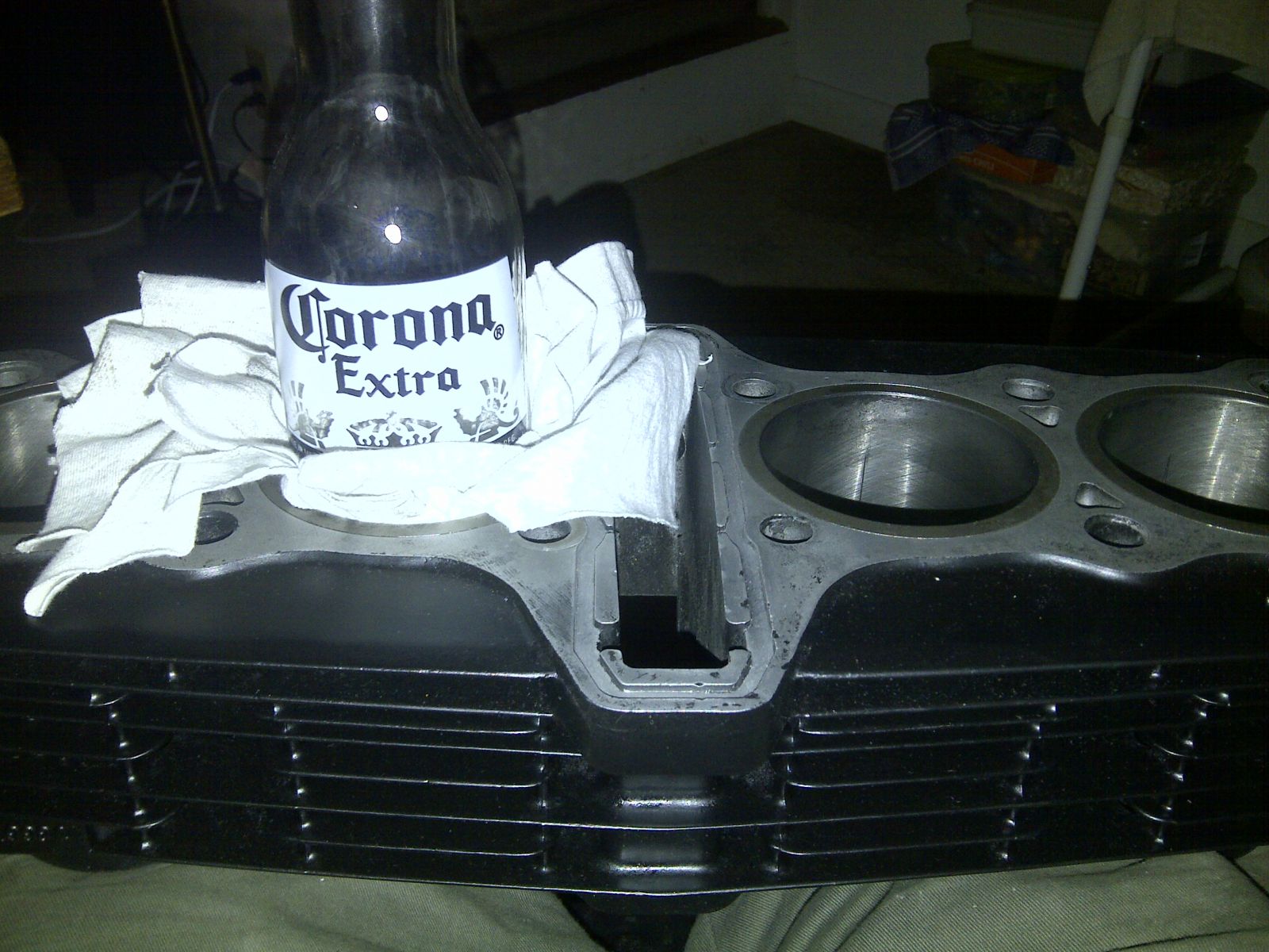

Well the jugs i have where bored but they had no chamfer so I spent the day very patiently trying but finally had to give up. I put a chamfer on the jugs and needed to wipe them out and this fit very nicely . I Know how to clean them correctly but this just got the worst of it.
