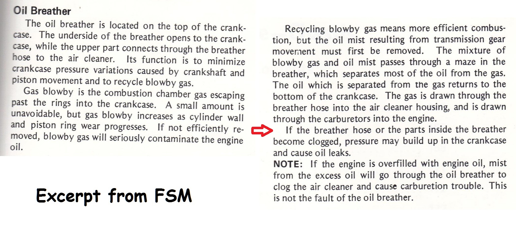

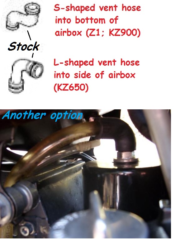

JimB wrote: No you should not cap it off. It needs to vent. You could connect a hose from and run the hose to the back of the engine. Or you can buy a filter from you local auto parts store and connectit right to the vent.
You can put caps oo the fittings on top of valve cover , no problem.
  • Patton
  • Patton's Avatar
  • KZr Legend
  • KZr Legend
  • Posts: 18568
  • Thanks: 2101
Re: How should I vent my tank?
17 May 2014 18:13 - 17 May 2014 18:17
#632795
The stock bike had the crankcase breather vented into the airbox.
Here's an example of using a hose from the breather vent to exit underneath the bike.
I'm not a fan of connecting an after-market filter to the vent.
18 May 2014 10:07
#632838
Looks like a great idea. I'm gonna have to do that. Thanks.
