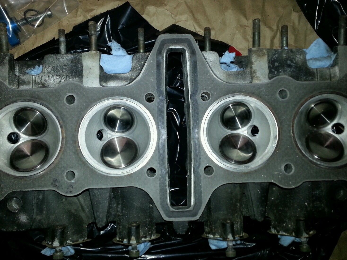

Whats wrong with this head?

Piston for that cylinder has matching dents.

- loudhvx
- Posts: 10864
- Thanks: 1619
Re: Whats wrong with this head?
06 Apr 2014 13:28
Everyone knows #4 needs to breathe more. :ohmy:
But, seriously, WTF.

Let me guess....Ebay purchase? If it is, then just contact the seller and work it out to get your money back.

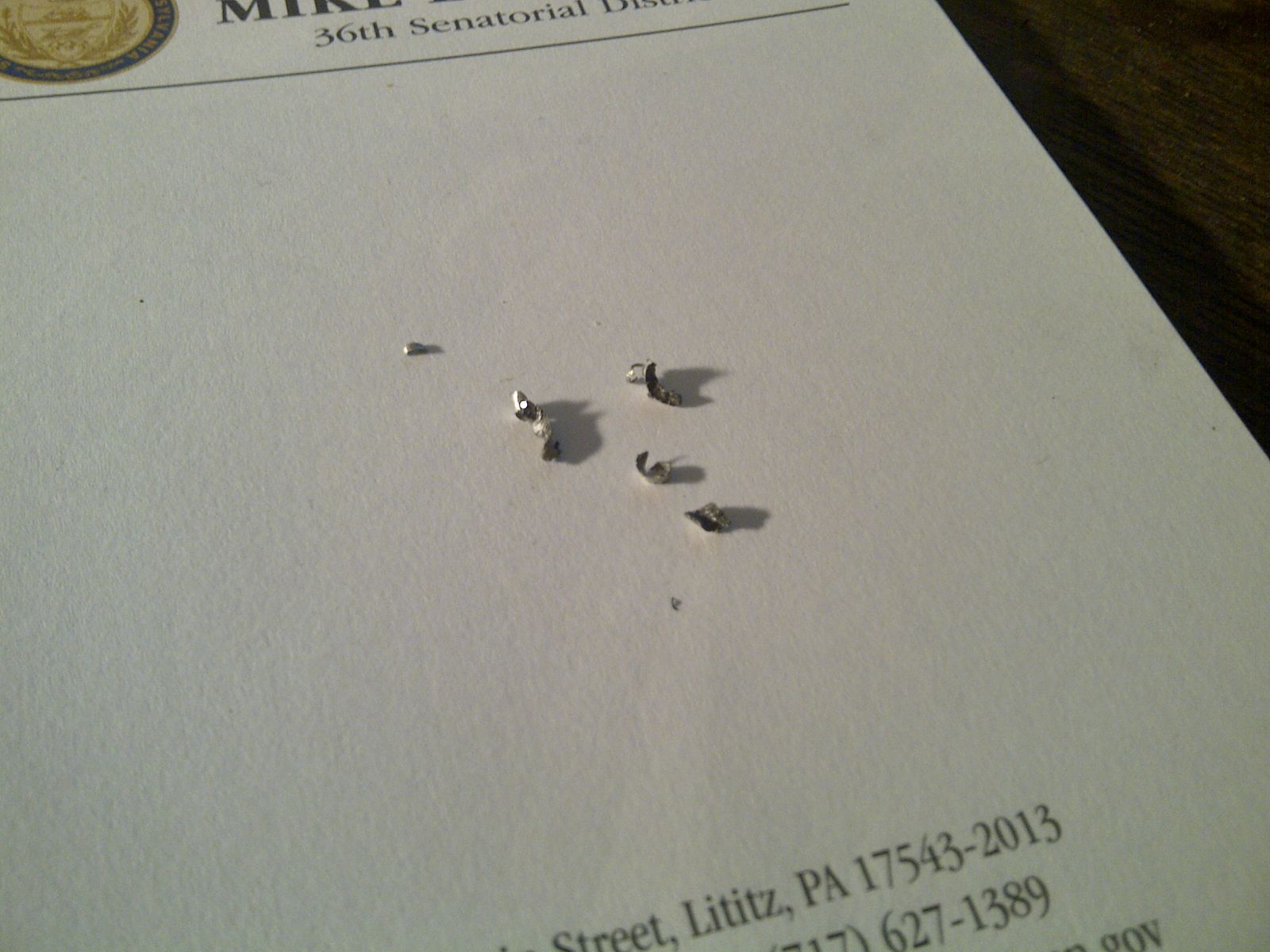

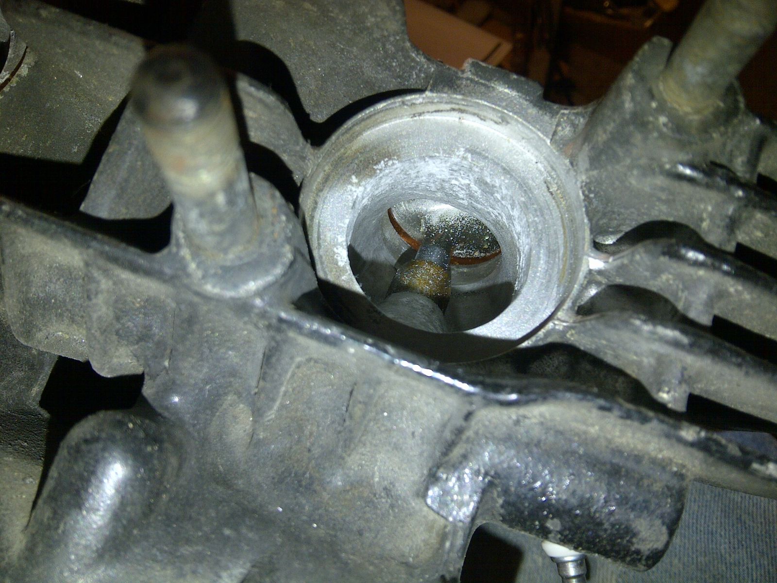

Ok so I got a new valve and pulled all the other too clearance the head and found all this crap still in with the springs. This is just from one.

Peter, that's just plain wrong! Contact the seller and demand your money back. I'd open a file with e-bay for a misleading auction. Hope it all works out for you.

Before you bolt that head on. Take a piece of small welding rod. Squeeze it in a vise to flatten one end. Grind it so that its .185" wide. See if it will slide between the valve heads while they are seated. If it doesn't and you have more than stock cams, I wouldn't advise running it without getting that situation corrected.
I mention that because the look close in the picture

I did that and it doesnt fit. So now I have another Fricken piece of shit.
