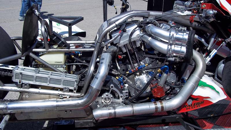

Custom pipes sounds like a good idea. I sold a set of flat black straight drag bikes from a KZ chopper about 10 years ago, I wish i had them now to cut up.
Yea! Staight pipes, Zommies! funnybike Injected pipes or some big diameter pipes like these.
