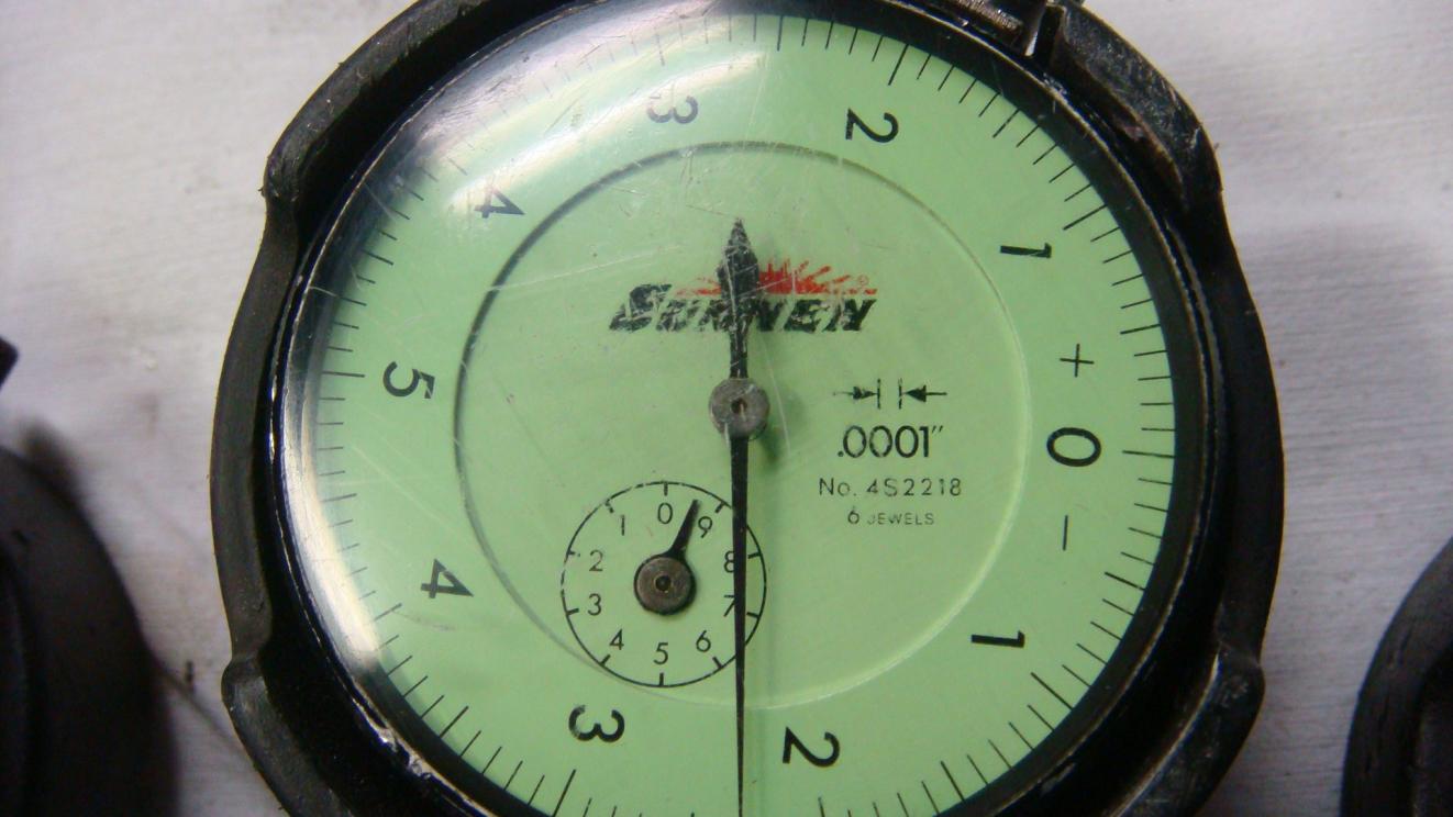

No, You have 2 tenths of a millimeter, not 2 tenths of a thousands.
My dial bore gauge is in thousands. thats why I work in thousands when measuring cylinders.
1986 RG500G 2 stroke terror.
Last edit: 11 Jan 2014 18:17 by Dr. Gamma. Reason: added picture.
