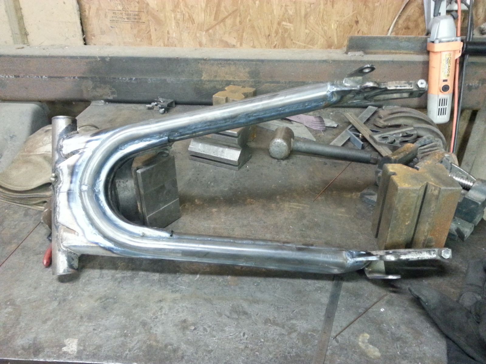

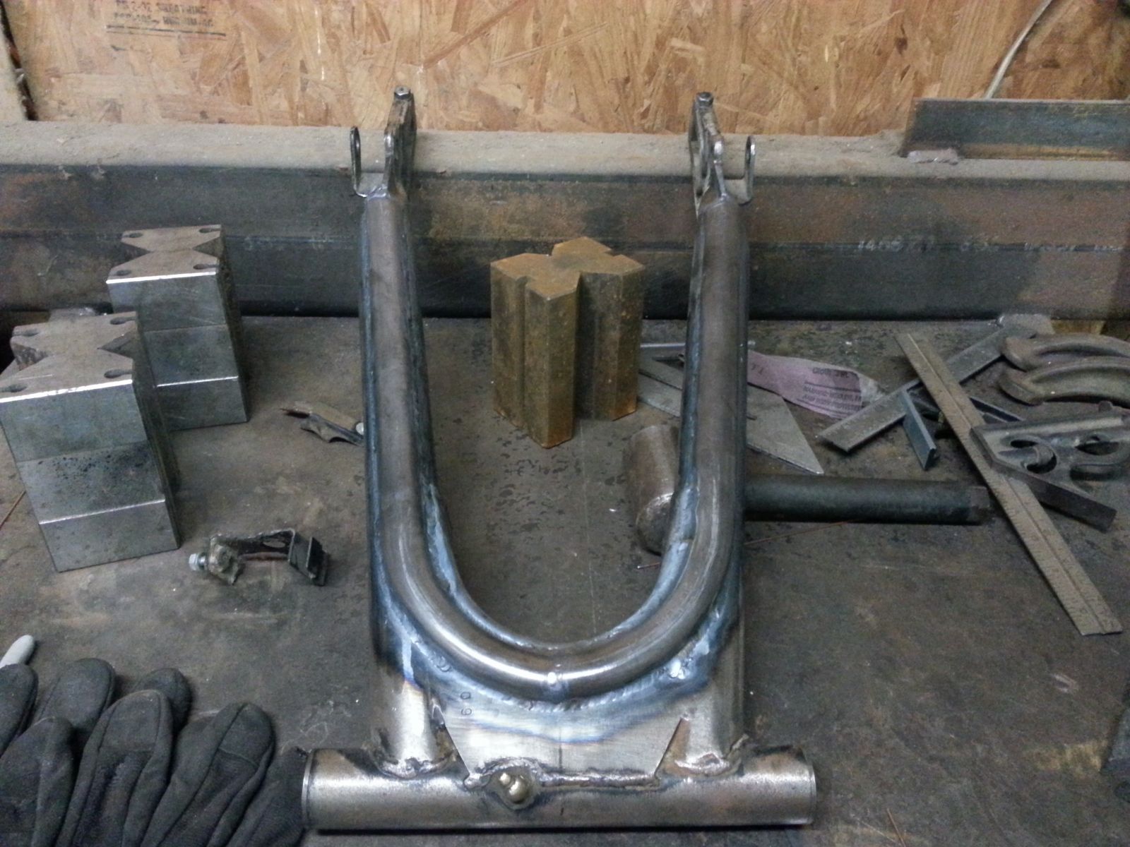

stealth overbrace for vintage style kz.
- Topic Author
i bent a piece of 1" 4130 chromo and then split it lengthwise and tigged it on.
that should help keep that skinny rear tire where it's supposed to be :evil: .

531blackbanshee wrote: that should help keep that skinny rear tire where it's supposed to be :evil: .
So that's why my rear tire has been coming around to the side of me (lol).
Nice work.

stock swingarms are noodles.
everybody talks about how flimsy the frames are.
but,
if the swingarm cant keep the tire inline the strongest frame in the world isn't going to matter.

that is better than what I had planned...oh my G^&...bling to the stealth....it is going to fit on this project like it aint even there...then someone will see it and be like...ah ha...anti bling..bling...oh and my 300 lb rider canyon rips will be stable now...

realized :evil: .
thanks for letting me help you bring your bike a lil closer to your vision sir.
can't wait to see it in place .
especially with some of your local backdrops :whistle: .

it wont draw attention until the bike is seen first then i a walk about it WILL draw attention from knowing kawasaki folks...friggin perfect Leon...man
