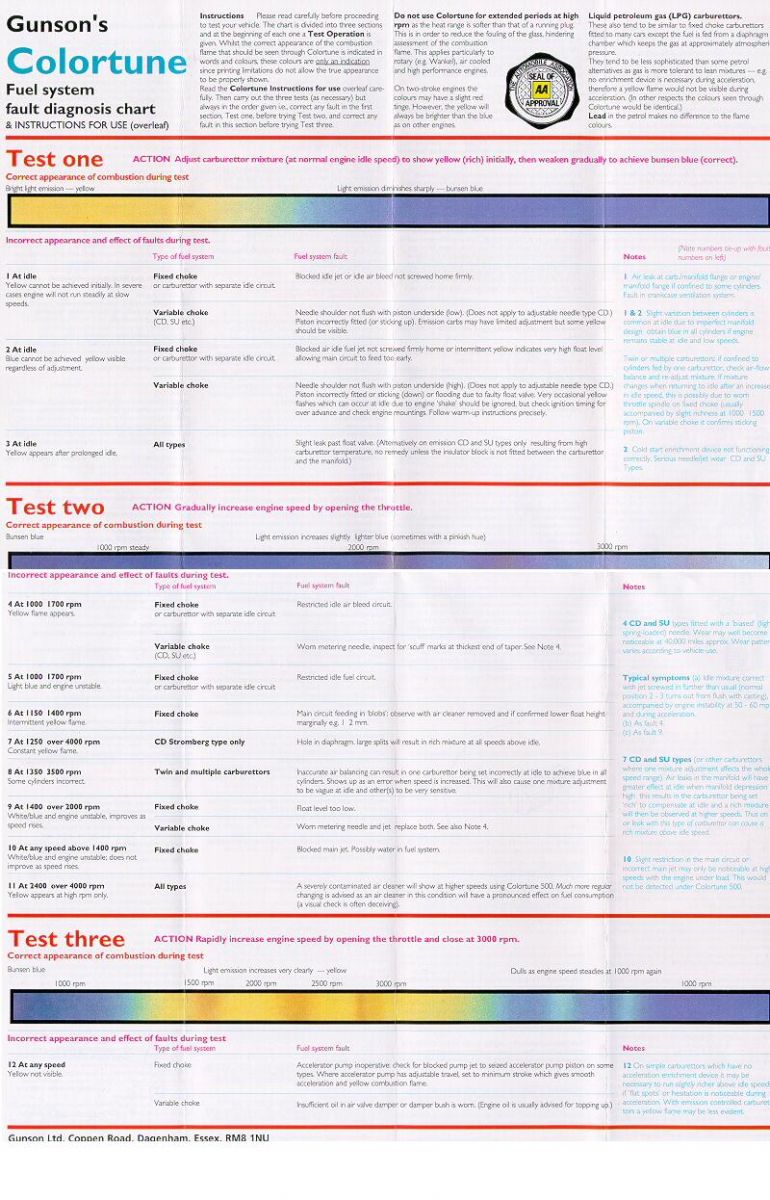

Colortune - by 3 adjustments do you mean pilot, mid range and mains? I only worked on the pilots and the air screw. Using the colortune did not seem as easy as I thought it would be. I'd turn the screw by 1/2 turns to look for changes in the flame color. I just bought the color tune based on your (OMR) comments about it in this forum, still learning.

OMR, my colortune did not come with that chart. I'll see if I can print it out and review it.
