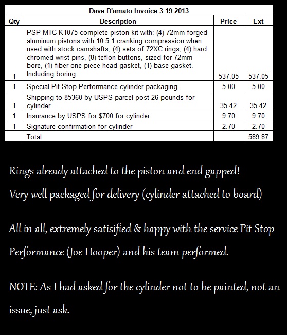

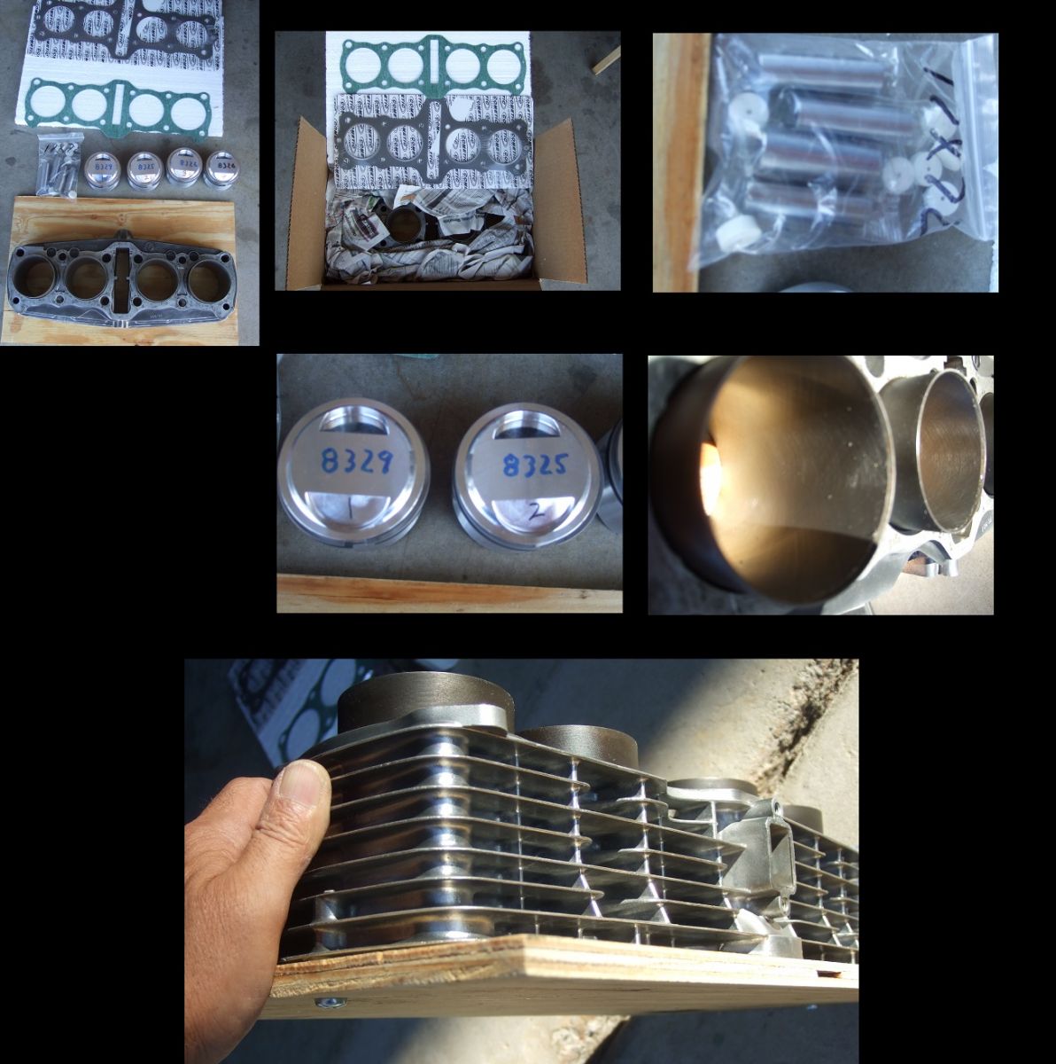

I'll go out on a limb and say nonsense. That sounds pretty expensive. Is that with him doing all the assembly and disassembly? Anyways, you should always shop around. If you need new pistons/rings/bore and head reworked check pit stop performance (
www.pitstopperformance.com
Here is a quote form the first page:
the piston kit for 1015cc, 1045cc or 1075cc will cost from $420.00 to $440.00.
The piston kit comes complete with rings, wrist pins,
circlips or Teflon buttons, head gasket and base gasket.
Boring costs $124.00.
So your total will be $544.00 to $564.00.
Complete Valve Job
The following is the labor that will be performed on your head: Disassemble head. Clean all parts. Bead blast eight valves. Bead blast combustion... You can read the rest on his page on what is done for this price, $311.45
Not sure if the price includes shipping back. And I would certainly expect that you have to pay the shipping to the shop.
I'm not affiliated with this shop and am not recommending it because I have not used them personally. Others can give you their experience in dealing with them. But I'm just including some numbers as a reference on cost. Now would hope you can find a local shop to disassemble and reassemble for you if you don't want to do that part yourself? I would guess $500.00. So $564.00 for pistons and borking + $311.45 for the head, Another $80 or so for a gasket kit and approx $500.00 for labor to disasseble and reassemble everything for a total of around $1475.00 excluding shipping costs. Still way ahead of $2000.00. And this place spells out what you are getting. Shop around. Good luck.
