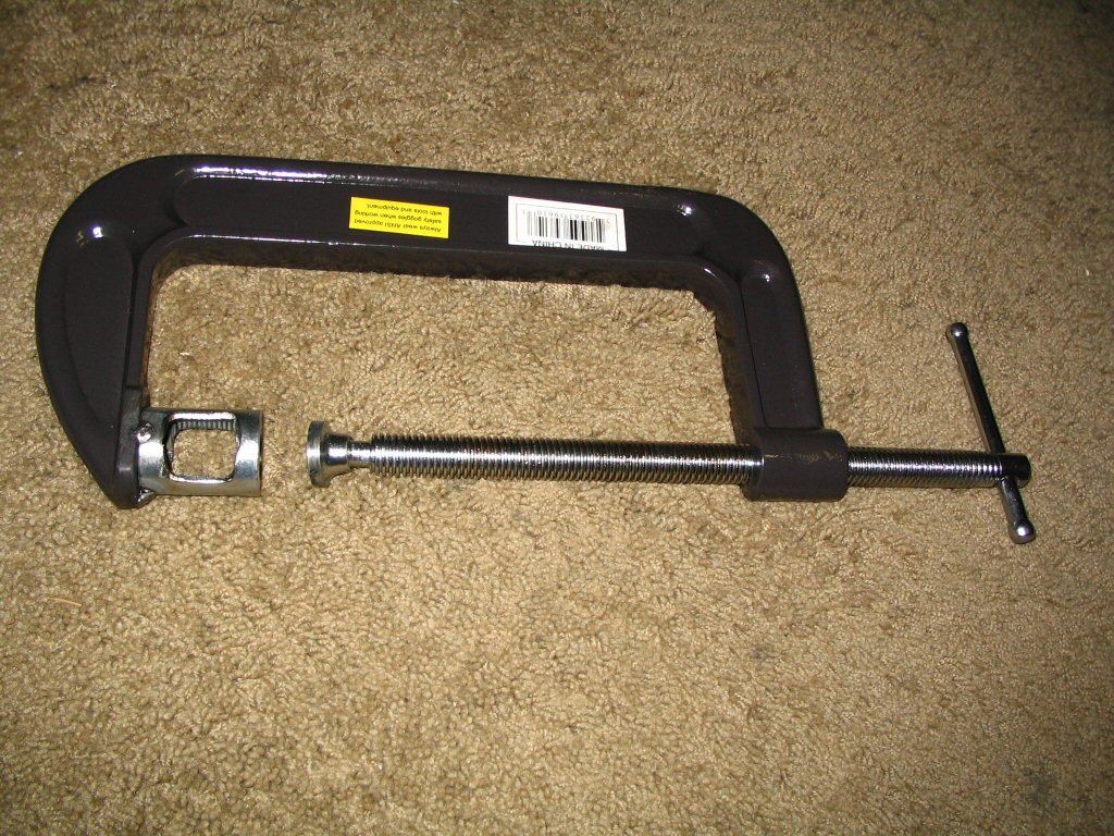

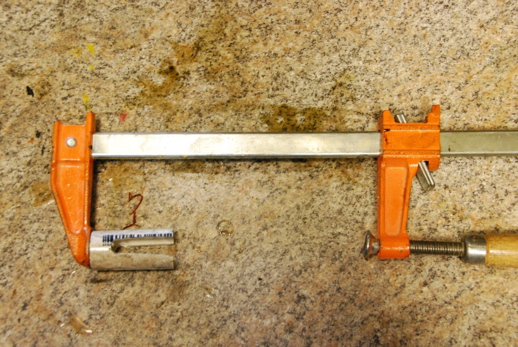

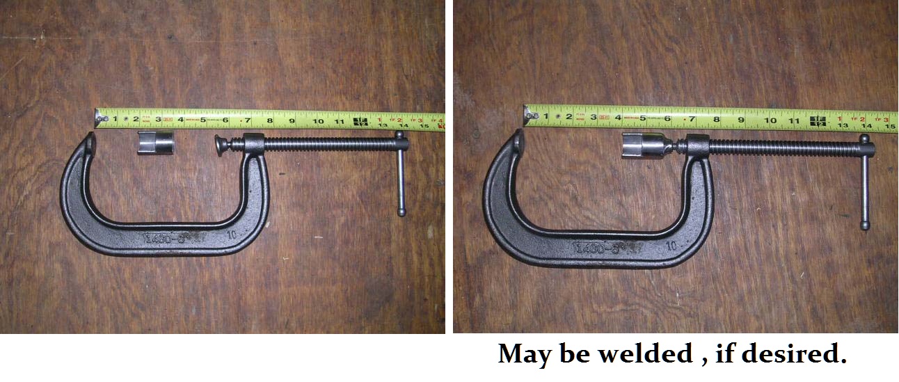

DIY valve spring compressor
May fab with metal pipe, a socket, or pvc pipe.
Could also search the Tools forum for more ideas.

02 May 2013 07:59 - 02 May 2013 07:59
Thanks for the suggestions :] I managed to do it with a cut pvc pipe. The first time around it was expanding when force was applied to it, however I used the bucket itself on top of the pvc pipe to hold it. Just so I put your mind at ease the clamp has plastic at the tips of the rod, so no damage to the bucket.
I'll upload a video later, probably tomorrow or the day after.
