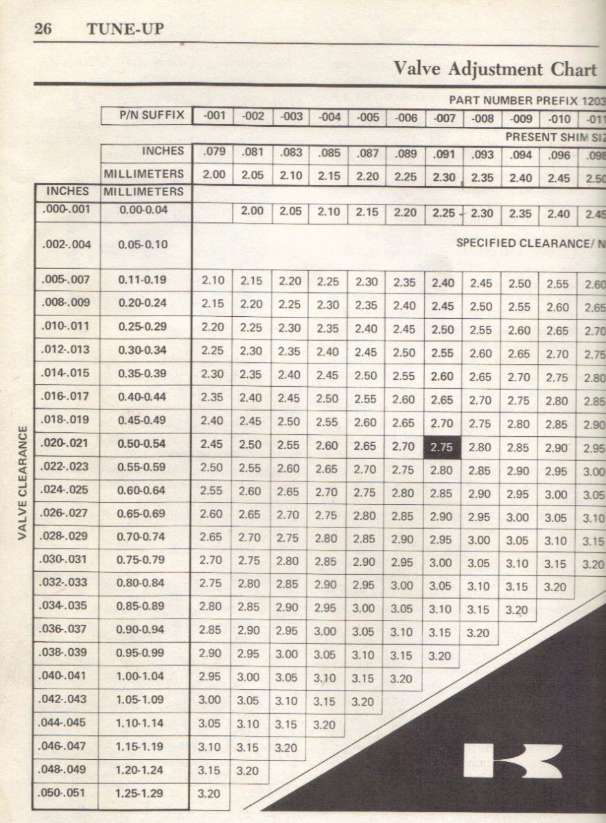

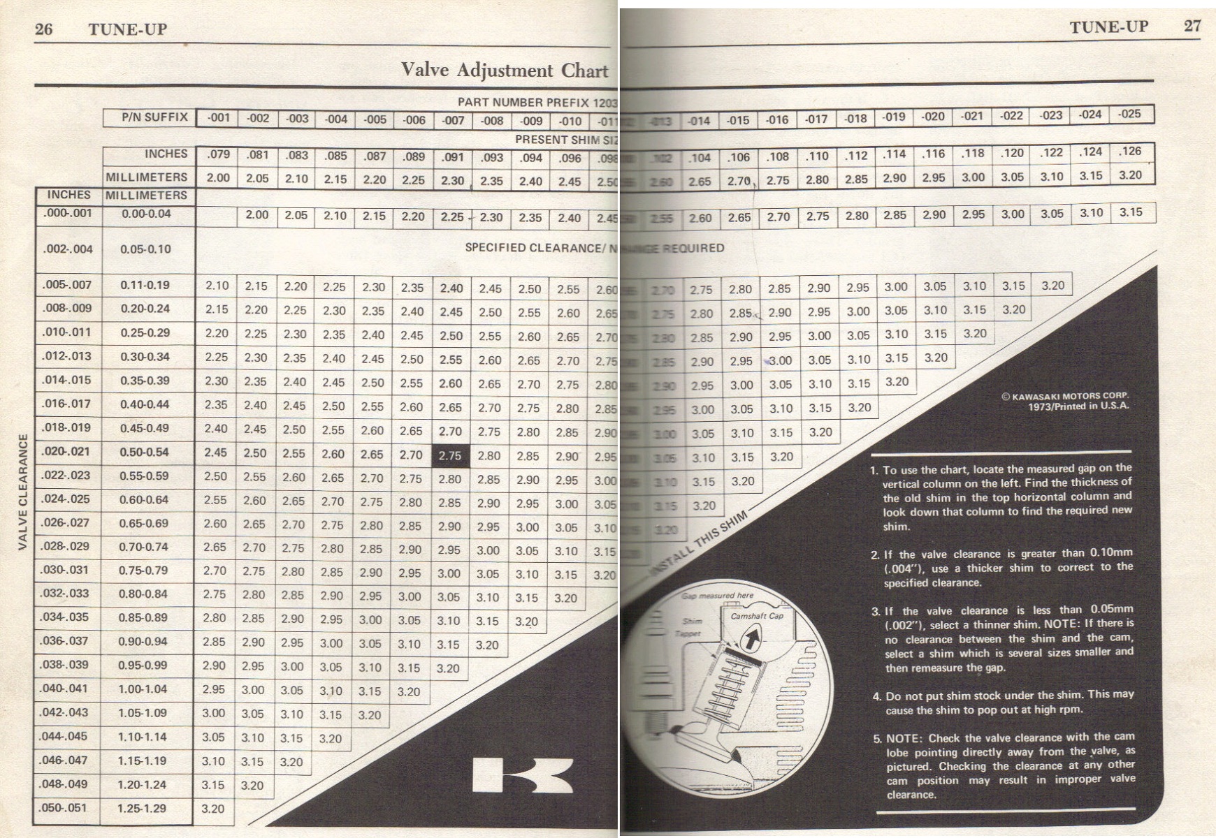

First time checking valve clearance.
Im pretty sure that .009 off the feeler gauge is 0.229mm or 0.23mm in the left column of chart.
Thanks.
WEB wants .006 valve lash that would be 0.20mm according to web site.
Thanks.
Attachment IMG0676A.jpg not found

Re: Valve Clearance Chart ?
05 Dec 2012 17:55
0.008"=0.2032mm
0.009"=0.2286mm
0.010"=0.2540mm
0.009"=0.2286mm
0.010"=0.2540mm
