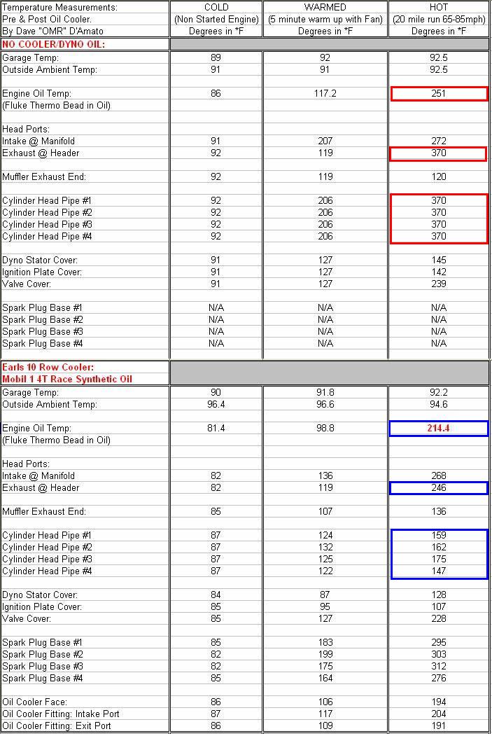

Here's some measurements made in AZ 94F ambient temp pre & post oil cooler... 370F was the highest measured on exhaust ports... I guess on where you live and engine builds/exhaust/CARB Jetting riding style makes the difference etc....
