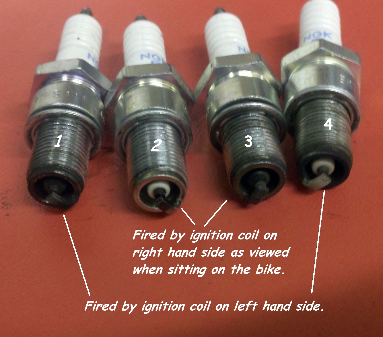

It sure looks like a top end rebuild at least, those compression #'s are way out of balance. That popping sound like a cylinder randomly firing, and an exhaust leak at either the pipes of head gasket?
You could do a leak down test to find where the compression is going, but really you need to pull it apart and rebuild. Then with the parts either out for service or whatever, check into the ignition system, also make sure those carbs are set up correctly. Jet them for the pods, and make sure the float valves function correctly, and the height for fuel is correct. Use the clear tube method, as it will verify the level for sure.

Sounds like running on three cylinders.
Which might also explain needing the relatively high idle rpm.
Would install four brand new NGKB8ES spark plugs and re-test.

Looking at your plugs,#1 and #3 are carboned up pretty bad.U may have a weak #1 coil.would give it a check per the manual,make sure all connections are good prior to tearing into an engine rebuild.Coils are relatively cheap compared to engine rebuild.bj

#446753
