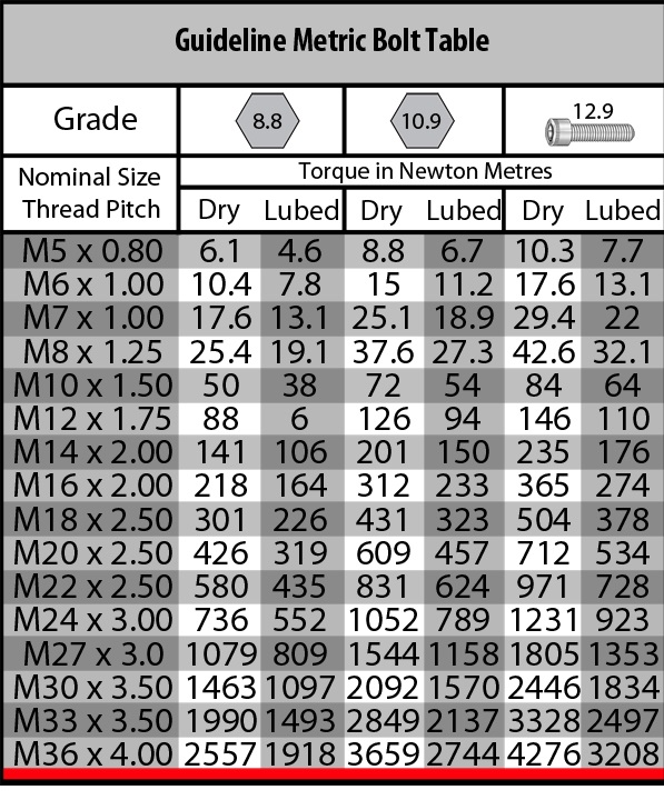

The preferred repair is to use heli coil or time serts. But first, try using a tap to re-do the threads and look for a longer bolt if there are any remaining threads in the bottom of the hole. The tap should be M6 by 1.25. A standard bolt is M6 by 45 mm I think.
- Warren3200gt
- Posts: 1683
- Thanks: 877
Re: Broke a cam cap on a 78 kz1000... Now what?
19 Jan 2022 13:09 - 19 Jan 2022 13:10
Are they not m6 x 1 metric standard?
Last edit: 19 Jan 2022 13:10 by Warren3200gt.
