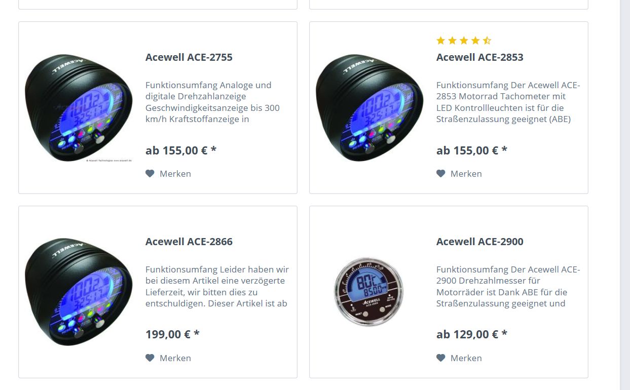

What type of speedo/tacho do you have?

acewell - all digital, works well but there are better ones for sure

Which is better?
I don`t want proximity switch etc...

motogadget - cream of the crop, I have the m unit fusebox its a treat to work with makes everything so neat and simple
