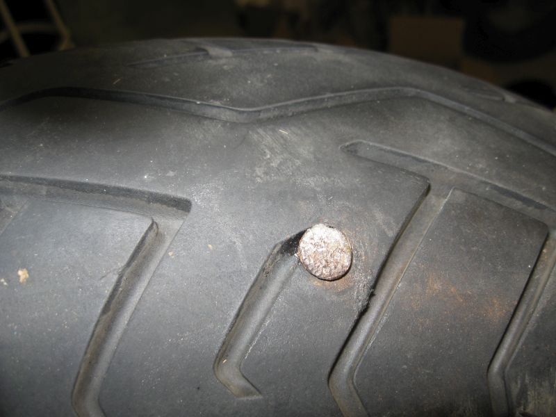

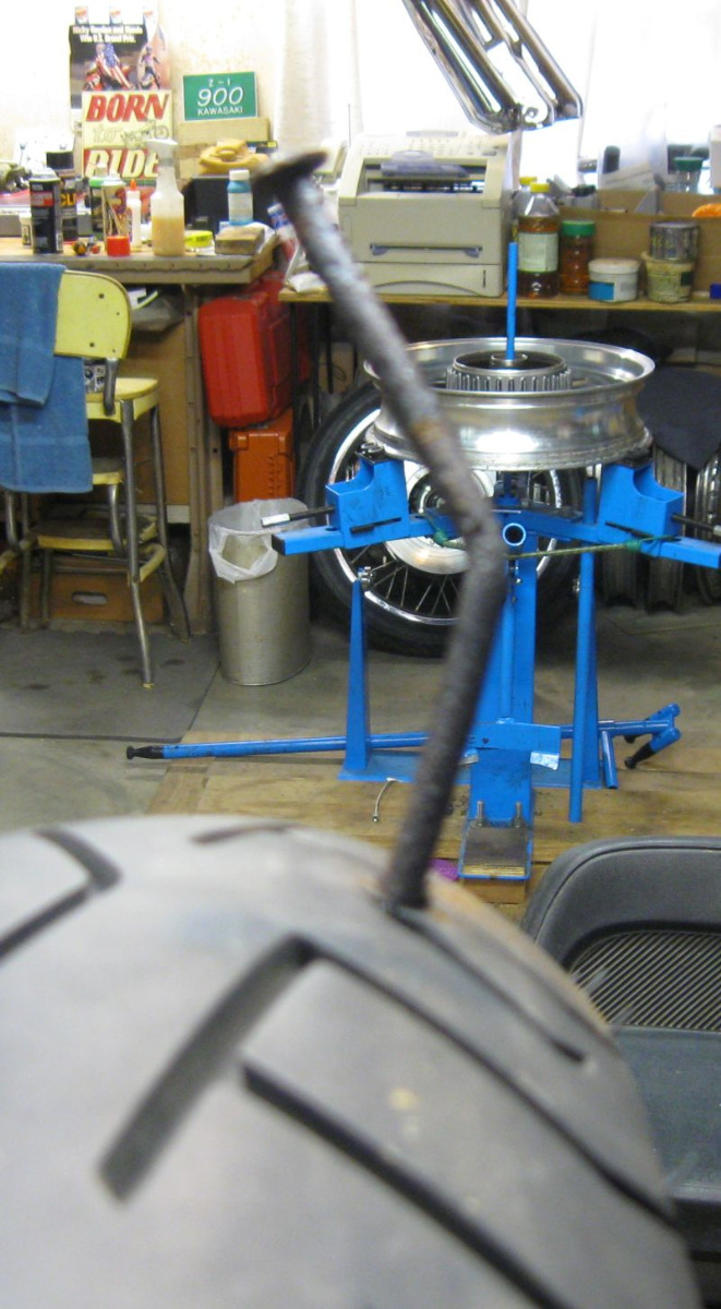

This is what I saw the first time I noticed the spike that Sun. morning away from home. This is taken at home after removing the gummy worm plug & re-inserting the spike to take pics.:
It was difficult to remove the first time. It was quite rusty & had obviously weathered for a long time prior to my encounter with it. Channellocks, much grunting & gnashing of teeth produced something akin to a paraphrase of that battery commercial; it just kept coming... and coming... and coming...:

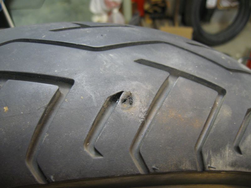

It's a dual-compound tire. The seam between hard & soft is visible just below the puncture. The spike left a reasonably clean puncture in the meat of the tread:

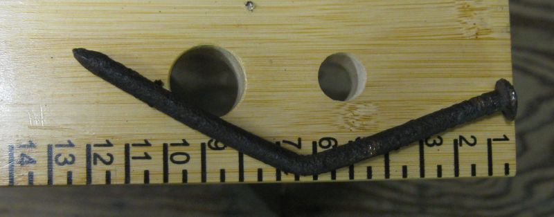

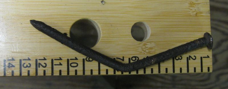

The offending object; 13 cm. (about 3.5"). Not sure, but I believe it was bent prior to my encounter with it:

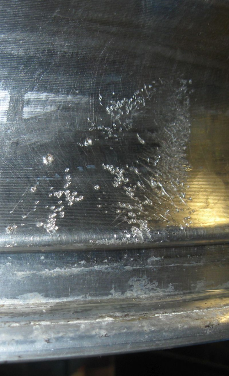

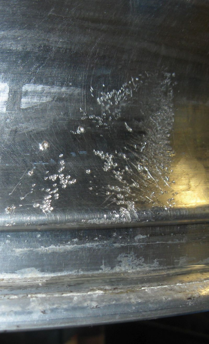

Before I ever looked at the inside of the tire, the first thing I noticed after dismounting the tire was the hundreds of "pekker marks" on the inside of the rim. They had to have happened during that 5 mi. after the puncture occurred:

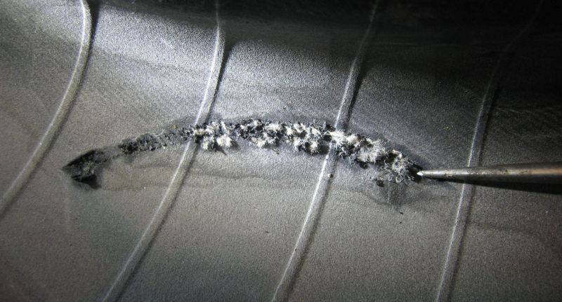

This next thing really spooked me, and will always make me carefully consider the wisdom of plugging a tire:
The tip of the awl is pointing to the deepest damage to the inside of the carcass. It's a hole about 3 mm. deep. This is NOT the puncture made by the spike; that puncture is out of the frame of this pic. The rest of the damage runs between 1~2 mm. deep. Cords in the carcass are obviously cut. Best guess is that the arc was created as the point of the spike swept across the surface each time the spike hit the road. The staining is from dried rubber slickum I used during tire dismount.

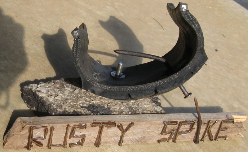

I'm considering cutting a section of the damaged area out of the tire, mounting it on a nice piece of wood complete with spike and having a plaque made, thereby creating a "Rusty Spike Award". It will be to recognize the next VJMC member who experiences a puncture during a VJMC National event.
