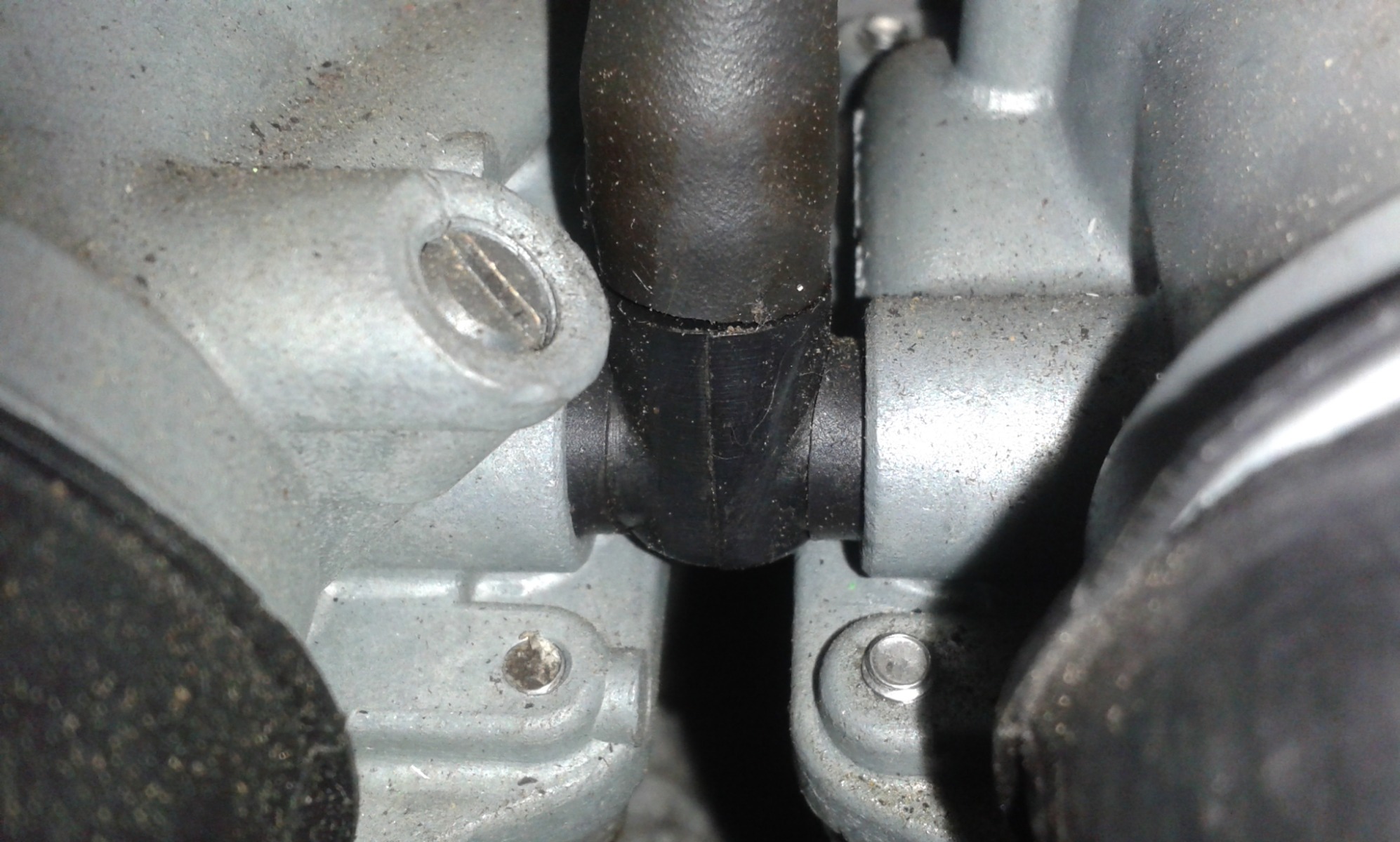

A little shrink tube mod on the stock fuel tees did the job on my Z1B carb set.
They never do leaking again over the years.....

Interesting shrink tube mod. Good pics too. How well does the shrink tube tolerate ethanol?

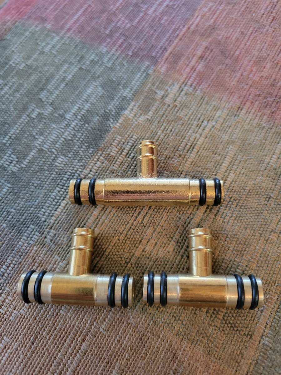

When I first started rebuilding carbs, I bought some aftermarket Tee's, different types, but I was never happy with the fit, nor the quality of the supplied O-rings. After that, I started making my own Tee's from brass, on a lathe. These worked fine, but are a fair bit of work. More recently, I've been buying these long size Tee's from China sellers. They are decent quality, other than the O-rings, which I change. For KZ version bikes, using two fuel Tee's, I mod them on a lathe. I've worked out all the dimensions for a good fit. These save a ton of time compared to building from scratch.
Regarding shrink wrap, or teflon tape, over cracks, I'm passing. Gasoline, inches away from the crotch, is nothing to monkey around with.

Im not a fan of the shrink wrap fix either. Just easier to do it correctly and not have to worry about it leaking. Iv seen a few posts about guys who have done it but I will pass also

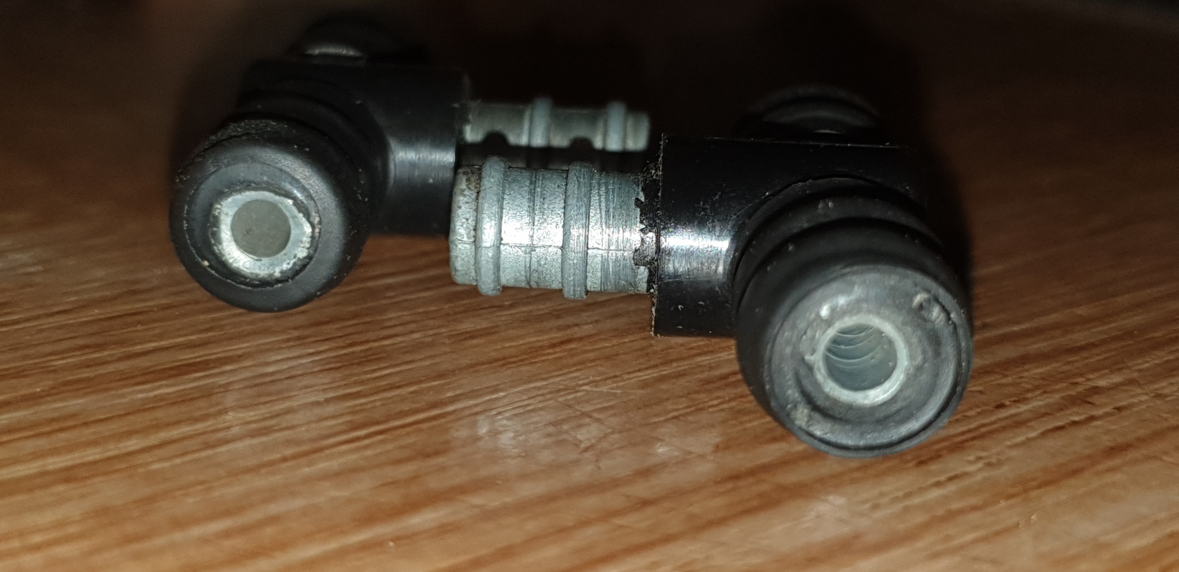

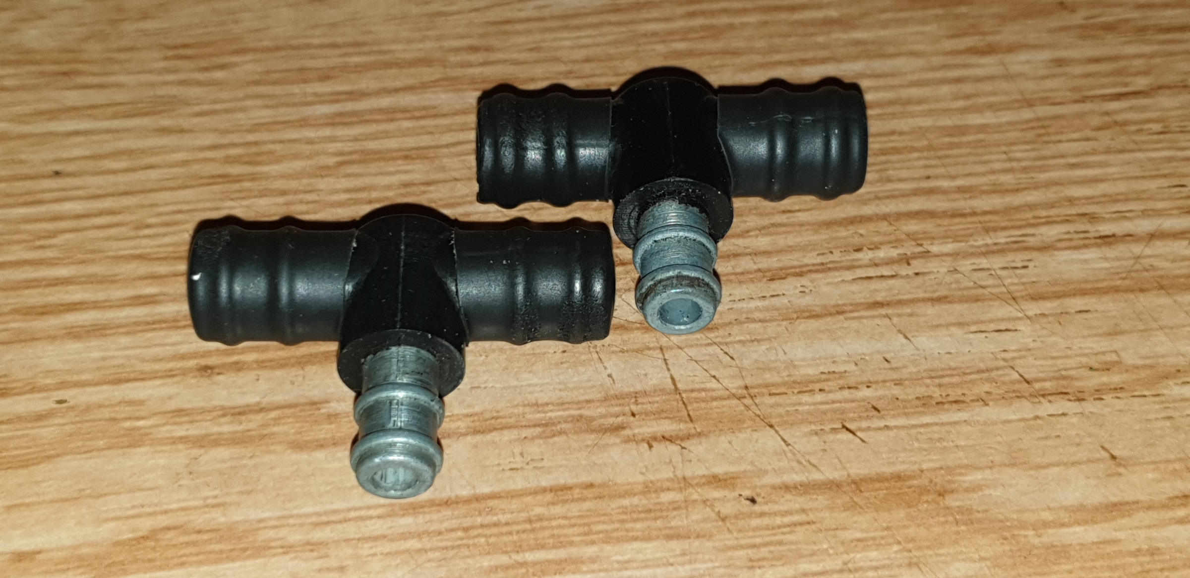

17 Dec 2024 07:01They were misplaced on the shelf & took 'till yesterday to find.We've used those aluminum T's on Z1 carbs before with no problems. We bought six sets plus spare O-rings for all six sets from Z1 Enterprises at Jeff's Mid-Ohio swap site the last year Jeff was there, so that's been ~10 yrs. or so. Maybe the O-ring stock has changed since then? We'll try measuring one for diameter of the ring cross section.
Good Ridin'
slmjim & Z1BEBE
Within the resolution of a good digital caliper & slmjim's questionable skill at measuring small, soft O-rings:
Cross section = 2mm
OD = 10.9mm
ID = 7.1mm

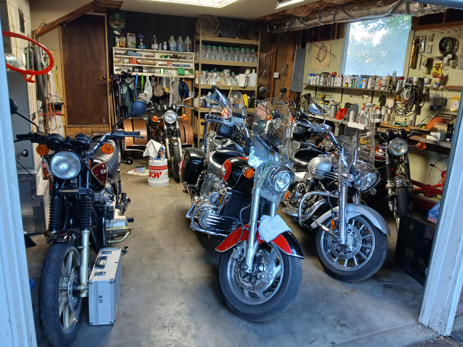

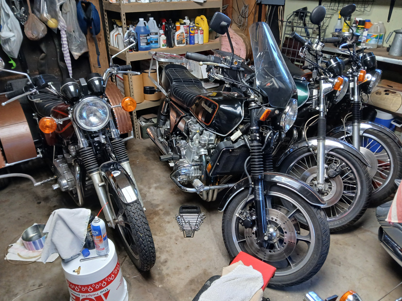

Well I got all the tanks and carburetors cleaned.
I filled the W3, the KZ900 and the KZ1300 with fuel and ran them enough to be satisfied they were sorted. I then drained the carbs and tanks, until next time.
I've got the KZ 1100 Spectre as one of the my three insured and registered bikes. The other two are a 2000 Valkyrie and a 2009 Yamaha RoadLiner S.
Here's a pick of the wife's garage. I get to fill it up during riding season with riders and Finished/Ready bikes.
I know, I know ! Where are the Kaws?
From left to right:
1979 KZ750 Twin Trike
1981 KZ1300
1976 KZ900
1979 KZ750 Twin
And at the far right of the first row is my 1974 W3.

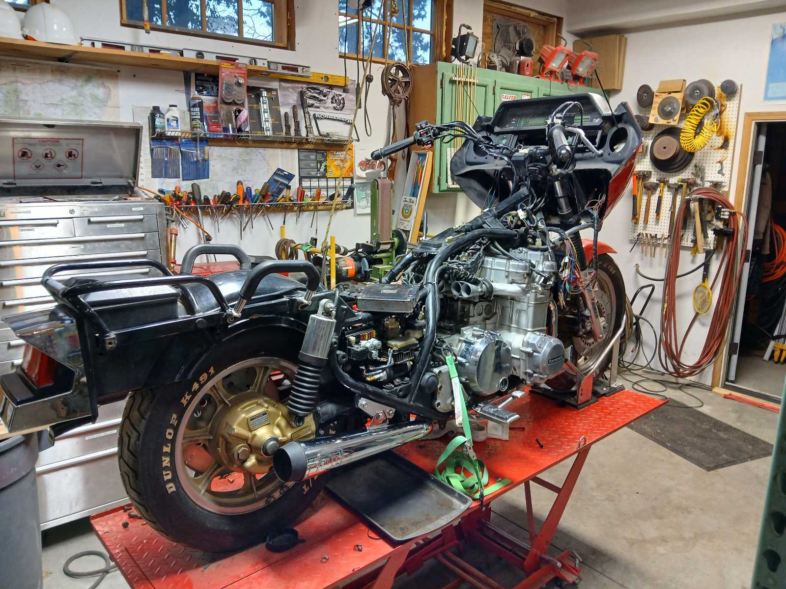

My current project is to undo the years of neglect I subjected my 1300 Voyager to until last year.
Up till then, I left the Voyager set full of fuel for at least twelve years. I suppose was hoping the fuel injection being a closed system could survive the layup. WRONG !
My first problem was that the fuel pump was stuck. Unfortunately, not only are they non re-buildable, then are also unavailable. I couldn't even find out the specs for the stock pump. I did know the operating pressure which is set by the regulator so I set out to find a pump that would provide enough pressure and flow but not so much that the inside of the tank would be a constant shower of vented pressure fuel.
I did find a fuel pump built by WalBro in the USA. It's a model GSL 393. Operating pressure 43.5 PSI with a max pressure of 50 PSI. It fit into the stock mount just fine I wish I could say it was the answer to my prayers but the bike wouldn't run, even with this new pump, it would sputter a good bit, but nothing without the starter. Next effort: Check out and clean the injectors.

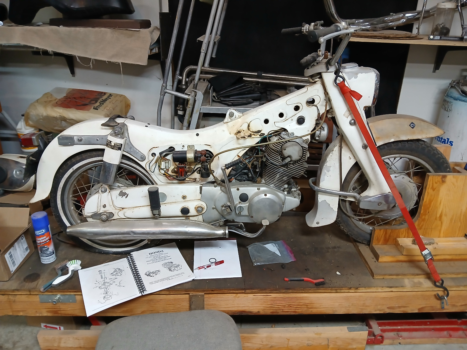

This Honda Dream needs some love. It belongs to a friend who just want's it gone. So Far I've cleaned the tank and rebuilt the carb. There's a big heavy box of parts that I should be digging through.

A fine stable William

An ole 305 Benly, haven't worked on one of those in a while! Guys used to try to "Give" me those because they were just taking-up space, denied denied denied the kind offer, ha. Would of been chill in my youth though!!
